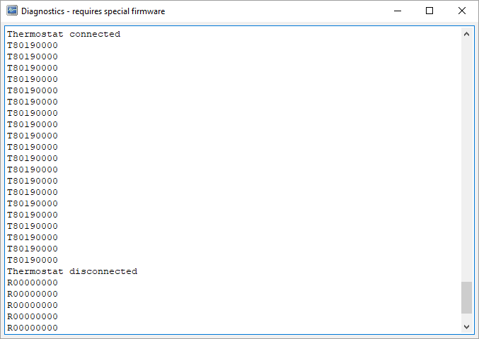

Today I hooked up the OTGW to a Windows system and noticed that the thermostat is getting some 'T80190000' signals but gets disconnected automatically after a few seconds resulting in 'R00000000' messages (see attachment). When I manually reconnect the thermostat it is again connected, but only for a few seconds.

- Diagnostics screen
- OTGW.png (10.68 KiB) Viewed 5382 times

The Diagnostics window is only supposed to be used with the diagnostic firmware. It is not very useful when used with the normal firmware. In that situation, you get much better information by looking at the Log tab.
T-messages are reports of what the thermostat is sending, not what it is getting. But there are no B-messages, so the boiler doesn't appear to respond.
It is unclear if the thermostat stops sending messages due to the lack of responses and switches to on/off mode, causing the "Thermostat disconnected" message, or if the voltage on the thermostat interface is close to the threshold and the disconnection detection is falsely triggered.
To check, you can use the command DP=57. This will report the measured line voltage after each message. A connected opentherm thermostat should normally result in values between 6 and 122. Values outside that range are assumed to be caused by the thermostat being disconnected, or using an on/off thermostat.

I don't know if the absence of a boiler is the cause of the disconnect in this case. But I know there are thermostats out there that will switch to on/off mode if they don't get an opentherm reply within a certain amount of tries after startup. So it's a possibility. More data will be needed to make sure.
The opentherm spec actually prescribes that a master should first try to use OT/+ communication. If no valid response is received for 20 seconds, it should switch to OT/- mode, which is basically on/off mode. Your screen shot shows 20 attempts before the "Thermostat disconnected" message. Coincidence?
