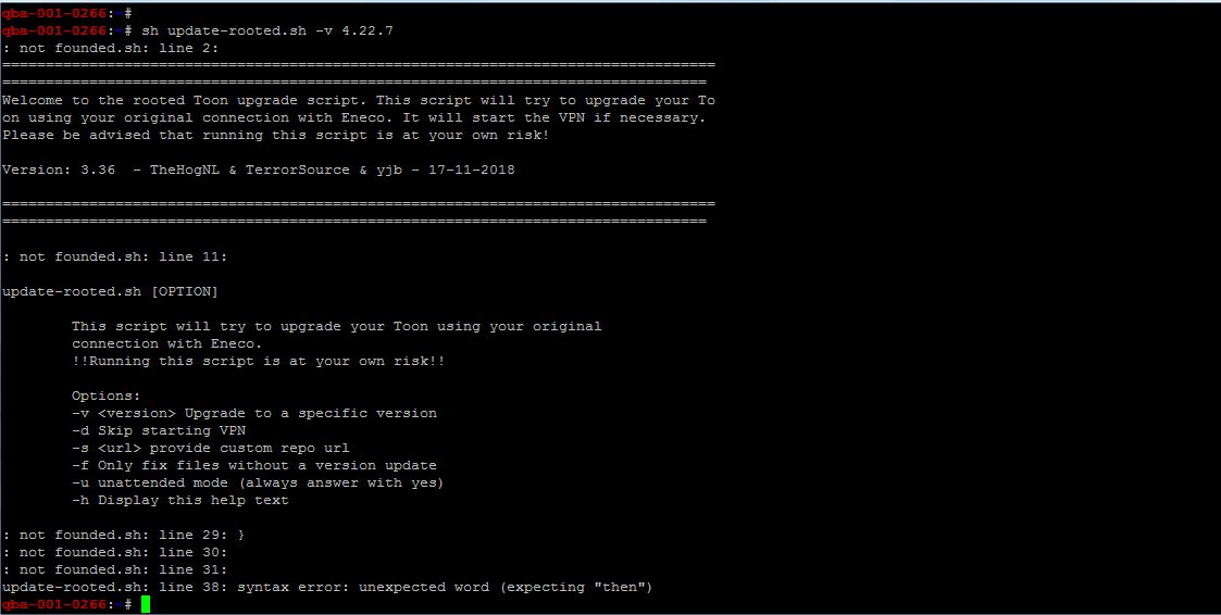

lievenco wrote:Is it possible to update my Boxx (Toon) with software version 1.0.9.
I tried the update script but, I ran in to some errors...
Could you post the errors (and a screen dump)? There's a strong possibility that your boxx is still running flash-based firmware. This can be updated, but it will probably require some manual tweaking.

lievenco
Posts: 3
Joined: Fri Oct 19, 2018 10:40 am
Re: Toon firmware - update script
Post by lievenco »
Here is a screencapture...
qba-001-0266:~# sh update-rooted.sh -v 4.22.7
: not founded.sh: line 2:

TheHogNL
Posts: 2125
Post by TheHogNL »
I helped you already. Updating a Boxx is not really working correctly yet with the script. Also your VPN didn't start up as your firmware was too old
