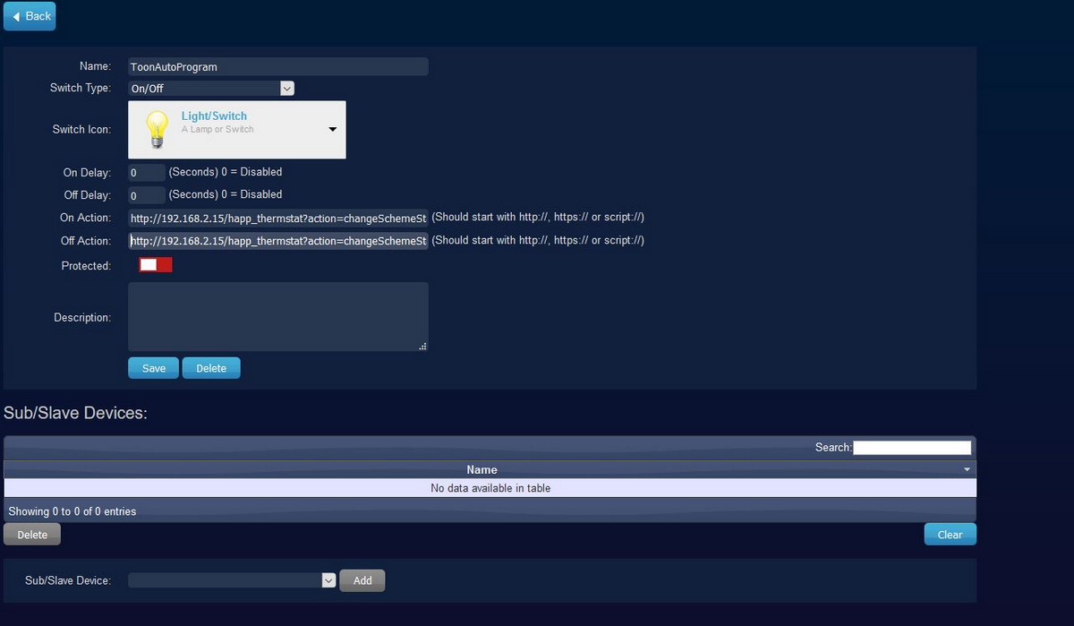

witteherder
Posts: 25
Joined: Thu Jan 10, 2019 2:28 pm
Re: Controlling Toon via Domoticz
Post by witteherder »
Hi TerrorSource,
I have a question.
What I need to do else in step 5A (see attached file)
I choosed the tabblad Switches because I dont see tabblad Sensors!!!
Maybe I m in the wrong tabblad?
Step 5A
Step 5A
Toon 2 Rooted User
Firmware version: 5.94.7
Raspberry Pi 3B+
Domoticz 2022.1
10 Neo Coolcam PowerPlus
Domotica Beginner (need little help in beginning)
TerrorSource
Posts: 494
Post by TerrorSource »
witteherder wrote:Hi TerrorSource,
I have a question.
You did not read the manual :D You created a wrong dummy device. Please re-do the steps.
