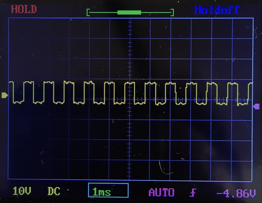

Sorry for the late reply,
i've found some time to check the logs after resetting the gateway:
11:32:00.182930 ÿOpenTherm Gateway 4.2.5
11:32:00.210047 Thermostat disconnected
Other than that I don't get anything.. It seems it also does not communicate with the boiler now (as it did properly before
). I measured the thermostat output and it does give short bursts of signal (see attachment). the voltage measured with my multimeter is quite low though (5.4 volt).
I'll check the board again later today to see if there something wrong with the soldering...
best,
Msarten

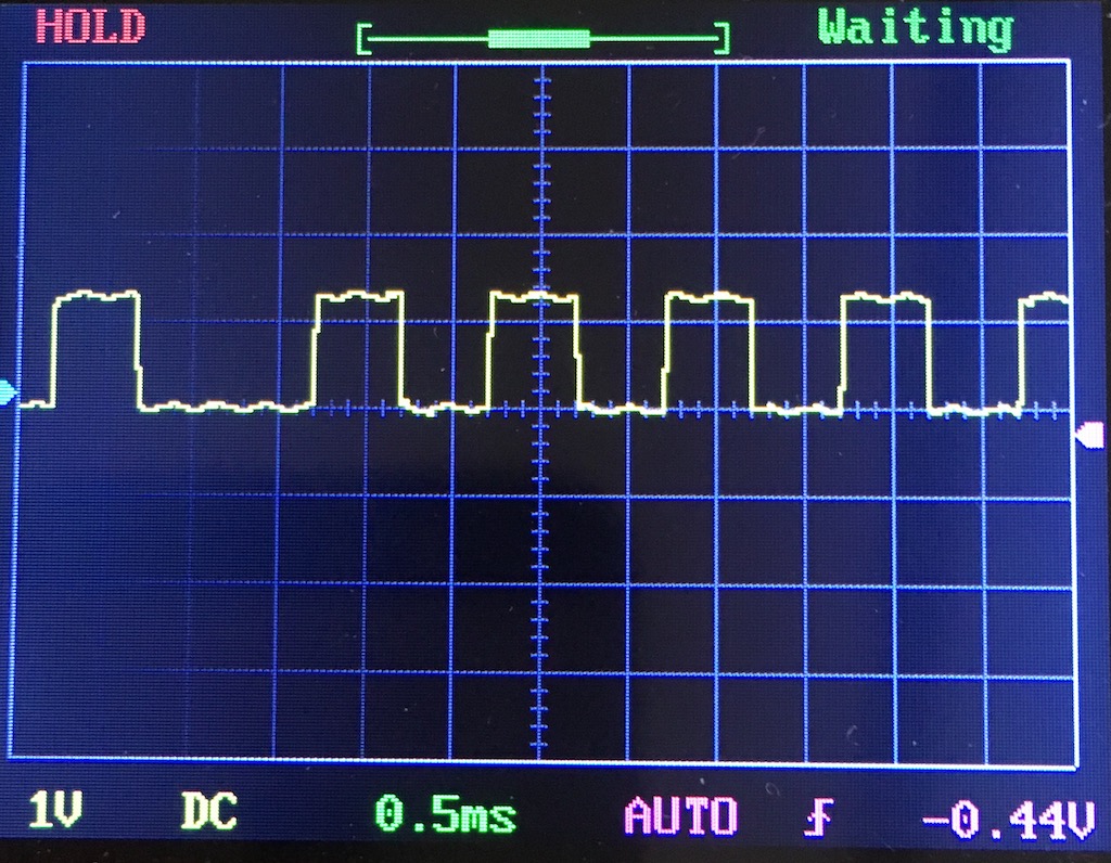

Thanks again for all your help! Great to get such good advice!
I issued the command and it reported DP=00 every time. measuring PIN 17 show 0.64volts and on my scope I see that there is a signal (from the thermostat?) but it is quite low (see attached). do you think there something wrong one of the
I'll try tomorrow if I can do some more tests with the diagnostic firmware.
cheers
Maarten

That signal looks fine. It has a 1.3V difference between the low and high levels. And if the low level is the 0.64V you measured with your voltmeter (the line is at the low level most of the time), then the levels are perfect. So it is strange that DP=57 always reports 00. 0.64V should result in 0x21 (33) or thereabouts.
This sounds like the A/D converter of your PIC may be faulty. The diagnostic firmware should provide more clues.
