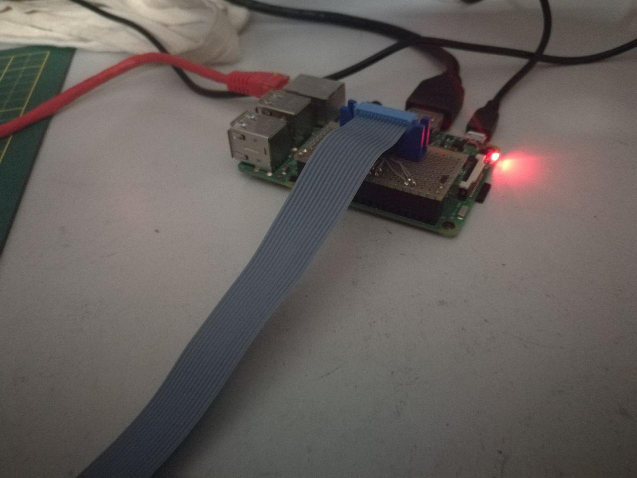

i haven make a conversion board from raspberry to toon
- photo_2019-06-05_23-56-35.jpg (100.04 KiB) Viewed 9703 times
