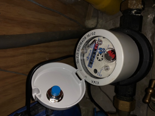

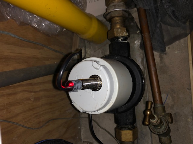

I drilled a hole in the lid of the water meter.
Sometimes the Toon watermeter shuttles between 4 and 8 liters, It is just not yet parallel to the water meter.
For now i am happy with it.
