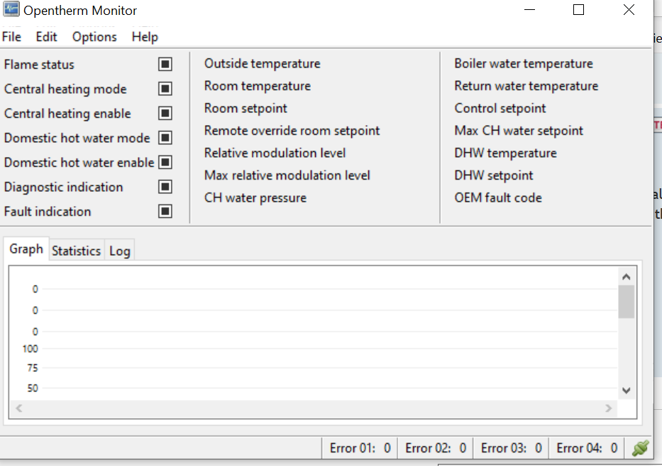

After this, i view youtube, https://www.youtube.com/watch?v=Rx-rUxzMN8Q The monitor showing nothing
- opentherm.PNG (128.48 KiB) Viewed 4001 times
Re: Backlight
It looks like you haven't got your OTGW/OTmonitor combination working yet. I suggest you focus on that first before worrying about details like backlight.
