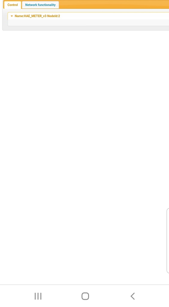

since recent the app doesn't work anymore for me, it says "not authorised" when refreshing?

when I open the page in a browser, I get to see some sort of zigbee (I think?) page, with the option to connect to other devices.

Could you show an screenshot?

Was already working on it, have to config portforwarding as I am at work at the moment, give me a minute.

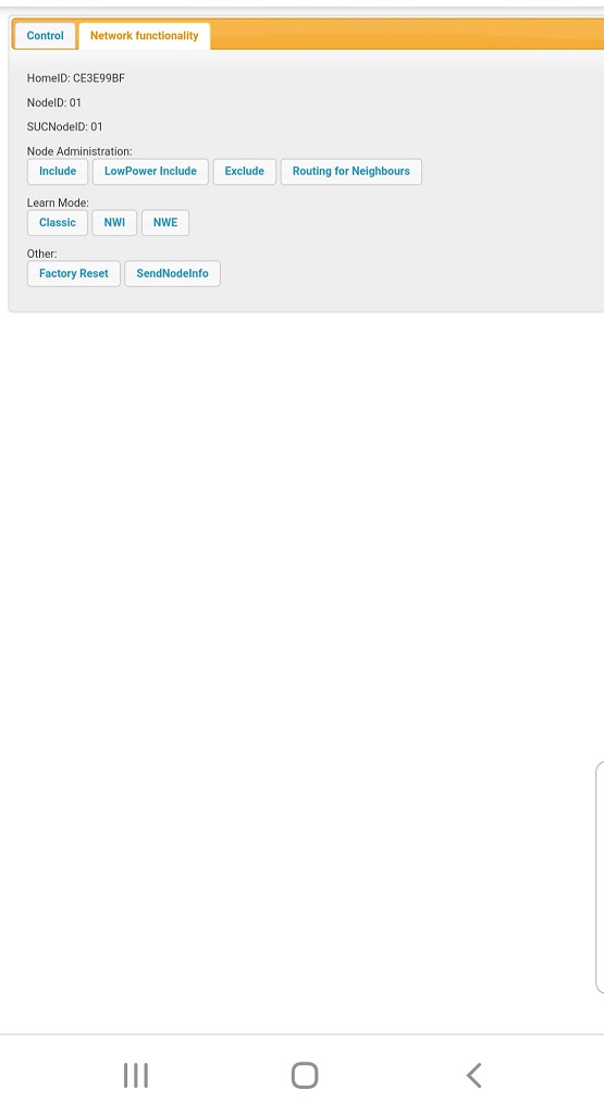

see attachment.
I think it happend after updating apps from the toon store.

This most certainly not Toon we're looking at.
I think Toon got a different IP adres and this is another device in your network.

That is the /hdrv_zwave page of the toon

Please check /qmf/etc/qmf_release.xml below hcb_web if enforcewhistlist is still on 0 (and if not change to 0 and reboot)

TheHogNL wrote:That is the /hdrv_zwave page of the toon
If I open that page on my Toon I get an error message:
{"result": "error", "error":"no action in request"}

ArieKanarie wrote:see attachment.
Please run update-rooted.sh with option -f
or

TheHogNL wrote:Please run update-rooted.sh with option -f
That did the trick :)
