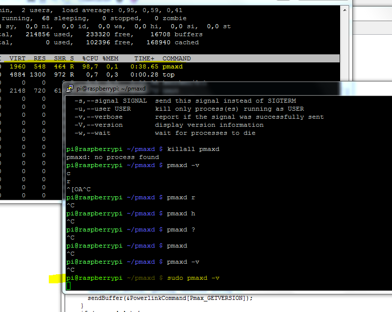

Its not working....
I've put the conf file in /etc/ after it error I/O not show
Execute pmaxd but doesn't work. The cpu is up to 98% but nothing happens
Any idea?

Now seems works....
It is needed complile with "gcc -fsigned-char" option.

 INFO: [Tue Jun 10 01:21:47 2014 initSerialPort:0074]Intentando comunicar con
 INFO: [Tue Jun 10 01:21:52 2014 initSerialPort:0085]opening /dev/rfcomm1
 NOTICE: [Tue Jun 10 01:21:52 2014 main:0460]PmaxInit....
 NOTICE: [Tue Jun 10 01:21:52 2014 main:0461]PASS
 DEBUG: [Tue Jun 10 01:21:52 2014 logBuffer:0160]BufferSize: 180
 DEBUG: [Tue Jun 10 01:21:52 2014 logBuffer:0161]Buffer: 30 03 B5 01 02 00 01 00 04 67 00 00 00 00 00 00 08 C0 B4 01 90 93 02 00 00 00 00 00 02 00 00 00 A8 C1 B4 01 00 00 00 00 00 00 00 00 11 00 00 00 75 73 65 72 63 6F 64 65 00 00 00 00 11 00 00 00 05 00 00 00 50 03 B5 01 00 00 00 00 49 00 00 00 00 03 B5 01 98 03 B5 01 20 04 B5 01 60 07 B5 01 C0 07 B5 01 00 00 00 00 00 00 00 00 00 00 00 00 00 00 00 00 00 00 00 00 00 00 00 00 00 00 00 00 00 00 00 00 00 00 00 00 00 00 00 00 00 00 00 00 00 00 00 00 31 00 00 00 C8 03 B5 01 07 00 00 00 08 04 B5 01 00 00 00 00 08 C0 B4 01 90 93 02 00 00 00 00 00
I have 8 zone:
 NOTICE: [Tue Jun 10 01:21:52 2014 PmaxInit:0163]zone: 0, name: R.D.C.
 NOTICE: [Tue Jun 10 01:21:52 2014 PmaxInit:0163]zone: 1, name: Etage
 NOTICE: [Tue Jun 10 01:21:52 2014 PmaxInit:0163]zone: 2, name: Salon
 NOTICE: [Tue Jun 10 01:21:52 2014 PmaxInit:0163]zone: 3, name: Salle a manger
 NOTICE: [Tue Jun 10 01:21:52 2014 PmaxInit:0163]zone: 4, name: cuisine
 NOTICE: [Tue Jun 10 01:21:52 2014 PmaxInit:0163]zone: 5, name: porte garage
 NOTICE: [Tue Jun 10 01:21:52 2014 PmaxInit:0163]zone: 6, name: volet garage
 NOTICE: [Tue Jun 10 01:21:52 2014 PmaxInit:0163]zone: 7, name: detecteur incendie
 DEBUG: [Tue Jun 10 01:21:52 2014 sendBuffer:0177]Sending the following buffer to serial TTY
 DEBUG: [Tue Jun 10 01:21:52 2014 logBuffer:0160]BufferSize: 12
 DEBUG: [Tue Jun 10 01:21:52 2014 logBuffer:0161]Buffer: A2 00 00 00 00 00 00 00 00 00 00 43
 DEBUG: [Tue Jun 10 01:21:52 2014 calculChecksum:0170]checksum: 001A
 DEBUG: [Tue Jun 10 01:21:52 2014 sendBuffer:0186]result of serial write:: 15
 DEBUG: [Tue Jun 10 01:21:52 2014 logBuffer:0161]Buffer: AB 06 00 00 00 00 00 00 00 00 00 43
 DEBUG: [Tue Jun 10 01:21:52 2014 calculChecksum:0170]checksum: 000B
 DEBUG: [Tue Jun 10 01:21:52 2014 main:0464]Sarting main loop....
 DEBUG: [Tue Jun 10 01:21:52 2014 packetManager:0342]Timeout while waiting packet: assumig packet is complete......
 DEBUG: [Tue Jun 10 01:21:52 2014 calculChecksum:0170]checksum: 0000
 ERR: [Tue Jun 10 01:21:52 2014 deFormatBuffer:0206]checksum NOK calculated:0000 in packet:000A
 ERR: [Tue Jun 10 01:21:52 2014 packetManager:0362]Packet not correctly formated
 DEBUG: [Tue Jun 10 01:21:52 2014 logBuffer:0160]BufferSize: 3
 ERR: [Tue Jun 10 01:21:52 2014 logBuffer:0161]Buffer: 02 43 BA
 DEBUG: [Tue Jun 10 01:21:52 2014 packetManager:0369]End of packet treatment
 DEBUG: [Tue Jun 10 01:21:53 2014 packetManager:0342]Timeout while waiting packet: assumig packet is complete......
 DEBUG: [Tue Jun 10 01:21:53 2014 calculChecksum:0170]checksum: 0084
 ERR: [Tue Jun 10 01:21:53 2014 deFormatBuffer:0206]checksum NOK calculated:0084 in packet:000D
 ERR: [Tue Jun 10 01:21:53 2014 packetManager:0362]Packet not correctly formated
 DEBUG: [Tue Jun 10 01:21:53 2014 logBuffer:0160]BufferSize: 31
 ERR: [Tue Jun 10 01:21:53 2014 logBuffer:0161]Buffer: 09 01 00 00 00 00 00 00 00 00 43 0D 0A 0D 02 43 BA 0A 0D A5 09 01 00 00 00 00 00 00 00 00 43
 DEBUG: [Tue Jun 10 01:21:53 2014 packetManager:0369]End of packet treatment
t NOTICE: [Tue Jun 10 01:21:56 2014 KeyPressHandling:0288]try re-enroll
 DEBUG: [Tue Jun 10 01:21:56 2014 sendBuffer:0177]Sending the following buffer to serial TTY
 DEBUG: [Tue Jun 10 01:21:56 2014 logBuffer:0160]BufferSize: 12
 DEBUG: [Tue Jun 10 01:21:56 2014 logBuffer:0161]Buffer: AB 06 00 00 00 00 00 00 00 00 00 43
 DEBUG: [Tue Jun 10 01:21:56 2014 calculChecksum:0170]checksum: 000B
 DEBUG: [Tue Jun 10 01:21:56 2014 sendBuffer:0186]result of serial write:: 15
 DEBUG: [Tue Jun 10 01:21:56 2014 packetManager:0342]Timeout while waiting packet: assumig packet is complete......
 DEBUG: [Tue Jun 10 01:21:56 2014 calculChecksum:0170]checksum: 0053
 ERR: [Tue Jun 10 01:21:56 2014 deFormatBuffer:0206]checksum NOK calculated:0053 in packet:0000
 ERR: [Tue Jun 10 01:21:56 2014 packetManager:0362]Packet not correctly formated
 DEBUG: [Tue Jun 10 01:21:56 2014 logBuffer:0160]BufferSize: 254
 ERR: [Tue Jun 10 01:21:56 2014 logBuffer:0161]Buffer: 00 00 00 00 00 00 00 00 00 00 00 00 00 00 00 00 00 00 00 00 00 00 00 00 36 00 00 00 02 54 00 00 B9 94 E8 BE 4C 95 E8 BE 40 E2 E7 B6 00 05 00 00 05 00 00 00 BF 00 00 00 3B 8A 00 00 00 03 1C 7F 15 04 00 01 00 11 13 1A 00 12 0F 17 16 00 00 00 00 05 00 00 05 00 00 00 BF 00 00 00 31 8A 00 00 00 03 1C 7F 15 04 00 01 00 11 13 1A 00 12 0F 17 16 00 00 00 80 76 EE B6 0C 95 E8 BE 00 00 00 00 00 00 00 00 00 C8 00 00 04 00 00 00 02 00 02 00 00 00 00 00 00 05 00 00 05 00 00 00 BF 00 00 00 31 8A 00 00 00 03 1C 7F 15 04 00 01 00 11 13 1A 00 12 0F 17 16 00 00 00 00 00 00 00 00 00 00 00 00 00 00 00 00 23 F1 B6 0F 00 00 00 0F 00 00 00 00 05 00 00 05 00 00 00 BF 00 00 00 3B 8A 00 00 00 03 100 00
 DEBUG: [Tue Jun 10 01:21:56 2014 packetManager:0369]End of packet treatment
 DEBUG: [Tue Jun 10 01:21:56 2014 calculChecksum:0170]checksum: 00F5
 ERR: [Tue Jun 10 01:21:56 2014 deFormatBuffer:0206]checksum NOK calculated:00F5 in packet:0000
 DEBUG: [Tue Jun 10 01:21:56 2014 logBuffer:0160]BufferSize: 7
 ERR: [Tue Jun 10 01:21:56 2014 logBuffer:0161]Buffer: 09 01 00 00 00 00 00
 DEBUG: [Tue Jun 10 01:21:56 2014 calculChecksum:0170]checksum: 00D1
 ERR: [Tue Jun 10 01:21:56 2014 deFormatBuffer:0206]checksum NOK calculated:00D1 in packet:0000
 DEBUG: [Tue Jun 10 01:21:56 2014 logBuffer:0160]BufferSize: 13
 ERR: [Tue Jun 10 01:21:56 2014 logBuffer:0161]Buffer: 43 0D 0A 0D 02 43 BA 0A 0D A5 09 01 00
 DEBUG: [Tue Jun 10 01:21:56 2014 calculChecksum:0170]checksum: 00BC
 ERR: [Tue Jun 10 01:21:56 2014 deFormatBuffer:0206]checksum NOK calculated:00BC in packet:000D
 DEBUG: [Tue Jun 10 01:21:56 2014 logBuffer:0160]BufferSize: 5
 ERR: [Tue Jun 10 01:21:56 2014 logBuffer:0161]Buffer: 00 00 00 00 43
Please any help!
Best regards

definitely a problem with timeout, try changing it, otherwise it is a pretty good start

It is working finally thanks to viknet !!!
Raspberry need higher timeout value
It is the make file with the correct options to compile pmaxd sources into raspbian

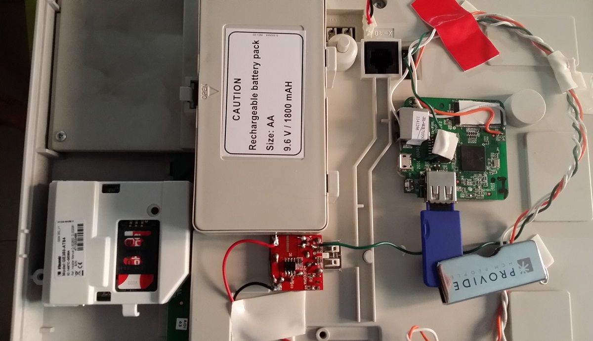

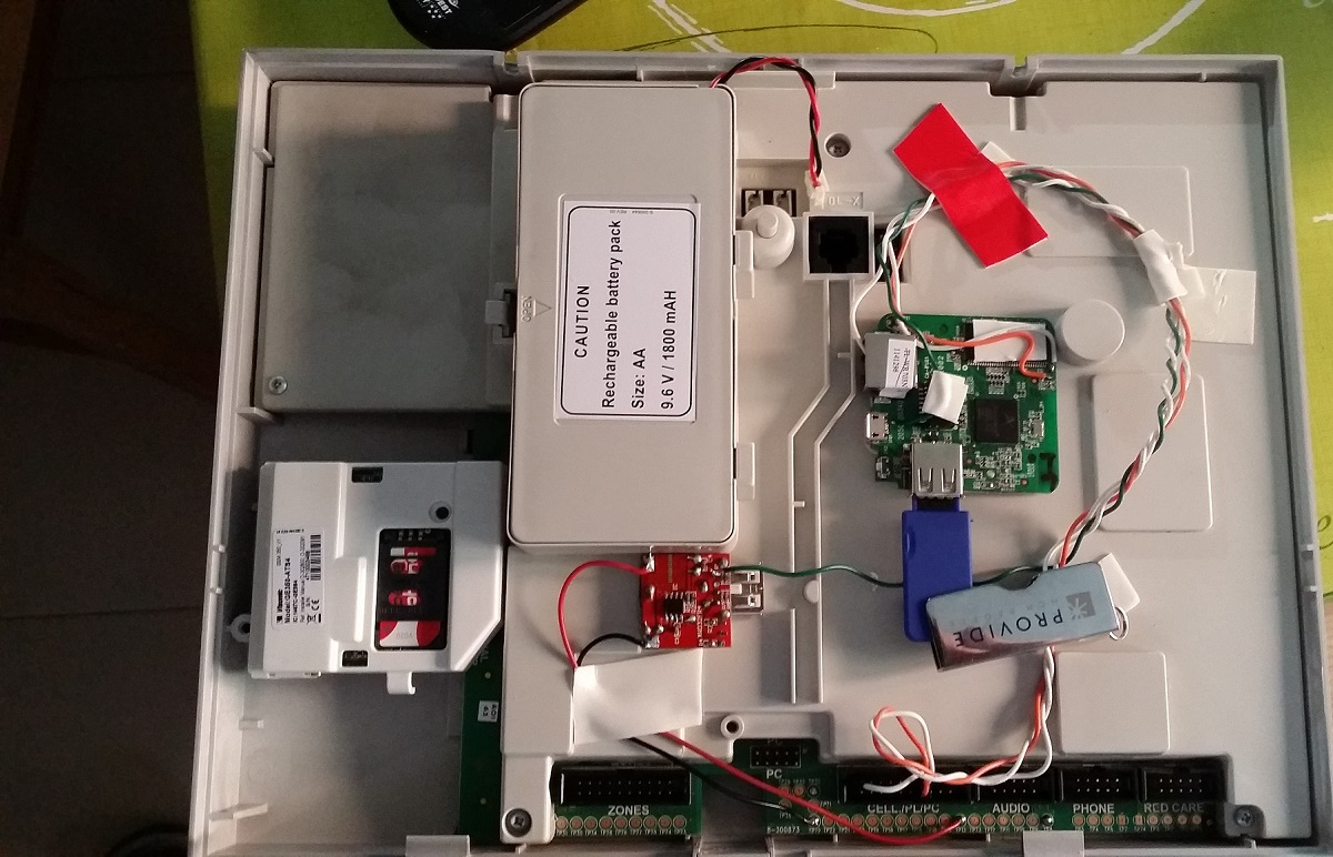

Finally mount wr702N
It's working fine!
