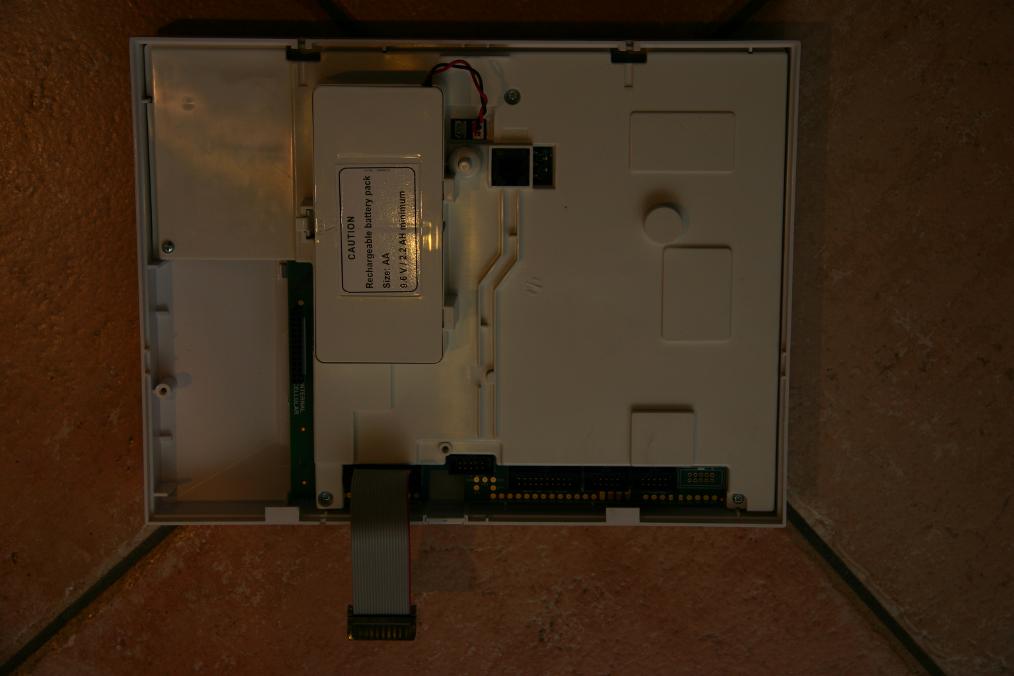

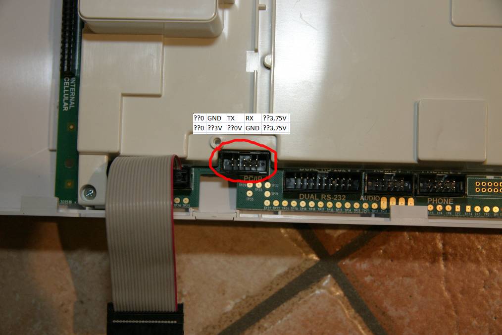

I had trouble finding the pinout of the powermax pro (without buying any cable), so with the help of a multimeter and a usb to 3.3V serial TTL adapter (such as this one cgi.ebay.fr/2pcs-USB-2-0-to-TTL-UART-6P ... 3a6f4cc144 but others from arduino/spakfun/adafruit will work) I found these information
I can confirm the pinout because I manage to link a PC using http://realterm.sourceforge.net/ and such a cable I manually calculated a checksum and manage to do the enrolement process.
for the posterity, please find attached two picture of the serial port, with your protocol the serial pinout and a small router such as this one TP-Link TL-WR703N
http://wiki.openwrt.org/toh/tp-link/tl-wr703n you can easily recreate yourself a free (not as in beer) powerlink.
Best regards
Viknet

for those too lazy for registering to view the pictures, the port is a 10pin header labeled PC /IP the pinout is described below :
_______________________________
|?0V   GND  TX   RX     3.75V |
|?0V   ?3V    ?0V  GND  3.75V |
             PC / IP
overview of the powermax pro panel
pinout of the 3.3V powermax to powerlink link

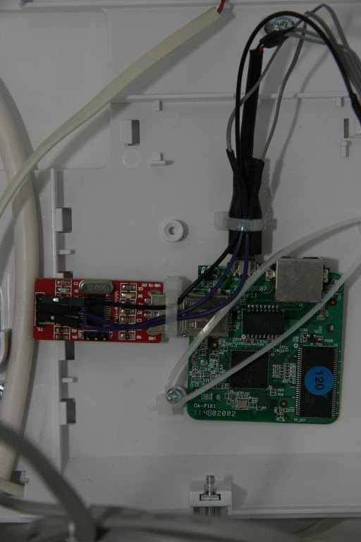

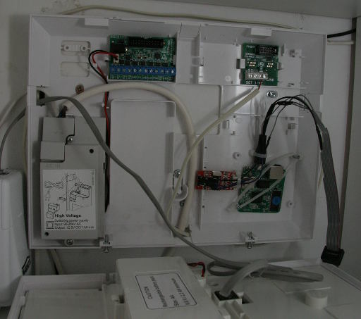

So I have build what I designed in my previoused post :-)

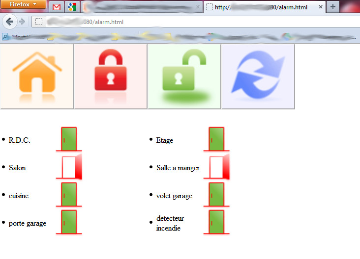

I have created a daemon in C handling all messages from the pmax and a web interface (designed with jquery and made for ios/android ) in C/cgi discussing with the daemon over xpl (xpl is an home automation protocol)
here are some picture were you will see the wifi router with an usb to serial interface and picture of the web interface
I will post the binary and sources (GPL if you ask) soon
zoom on the router and cable
overview of the pmax pro with the installed router
pmax daemon web interface

If you look at picture 1, you see that VIKNET uses PC/IP connector and not RS232 connector
I am using Viknet' material: TP link + USB/serial cable = 25€ and all is OK
