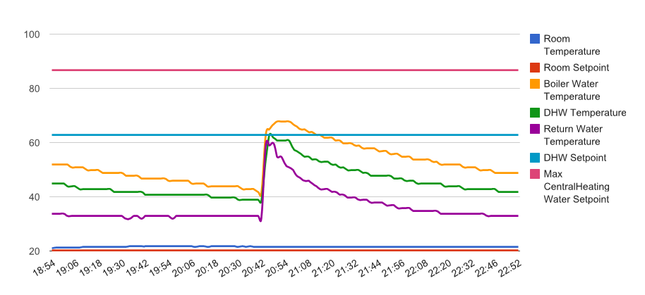

Just moved the gateway to the attic and fiddled around with some google graphing and some perl code:
