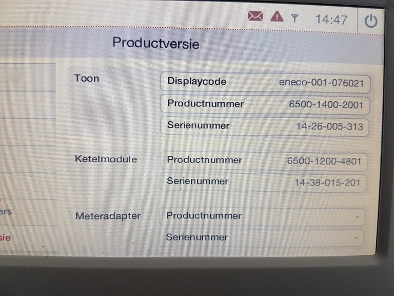

So, bought a one via MP. I looking never used :-).
Toon is working, It start up. I send allready a mail to Quby for getting root access to the Toon. Hopefully they give it.
How can I see the boot version of the Toon, without connecting the Toon via usb to the PC?
Re: Toon black screen
I'm not entirely sure, but if your display's serial number starts with 16, there's a strong possibility that it's boot loader version R10.
Only when you look at the boot loader output at boot, you can be sure (for now).
EDIT: yes, this one should be easily rootable (production year 2014, serial number 14-xx-xxx-xxx)
