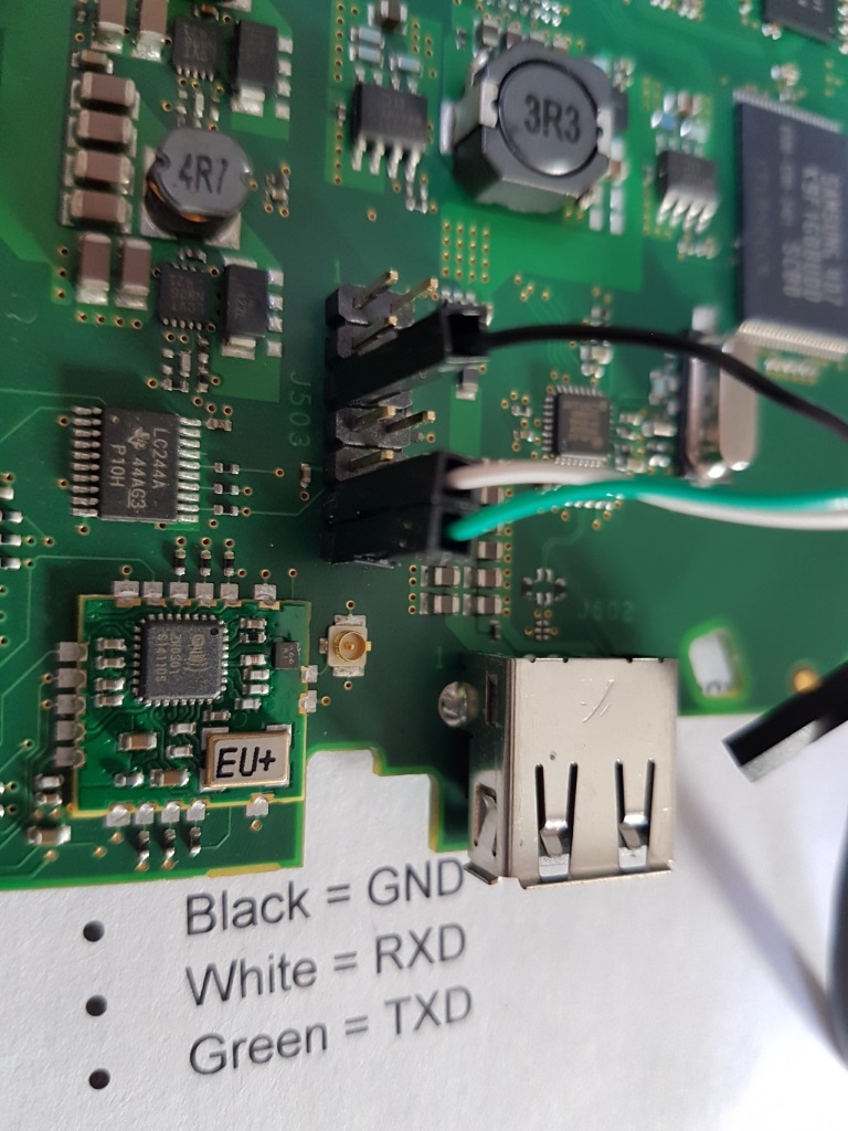

- Serial connection on the Toon
- 20161014_095831.jpg (249.06 KiB) Viewed 16124 times

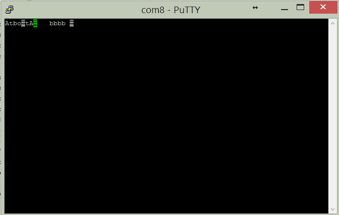

- PuttyScreen
- puttyscreen.png (4.15 KiB) Viewed 16132 times

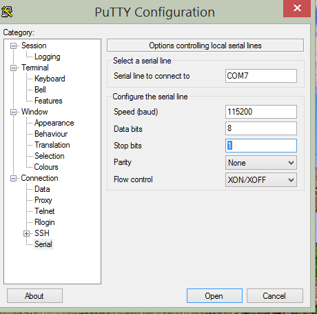

- PuttySettings
- settingsPutty.PNG (23.15 KiB) Viewed 16132 times

Advice of Marcel to set Flow Control to None, also give the same results

Hi cvdpol01,
You have 8, 12 and 14 connected.
It should be 11, 13 and 14
(instead of 14 GND you can use 3 or 5 which also are both GND. I used 5 so all connections are on the same row)

Also put Flow control = off (or none).

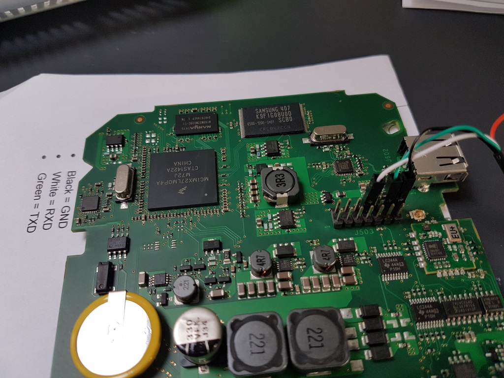

I change the connects as you said, see photo. Also set flowcontrol of.
The putty terminal don's show anything. When I hit the space, the cursor react.

- 20161014_110622.jpg (213.66 KiB) Viewed 16099 times
