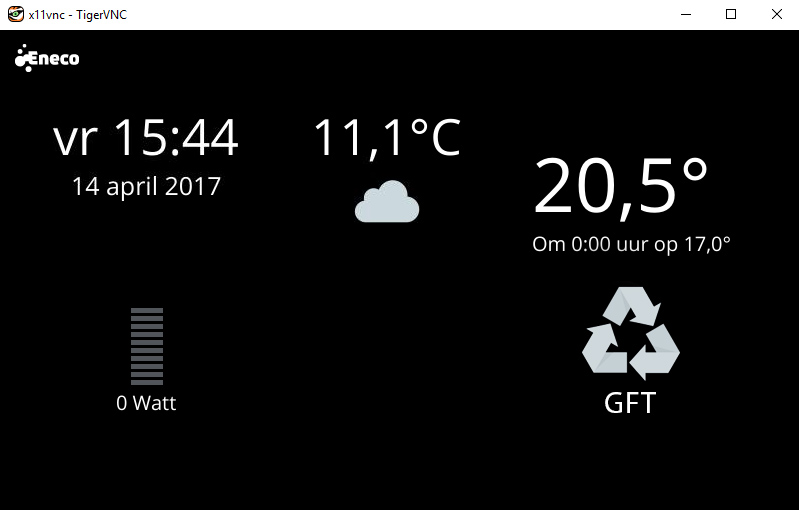

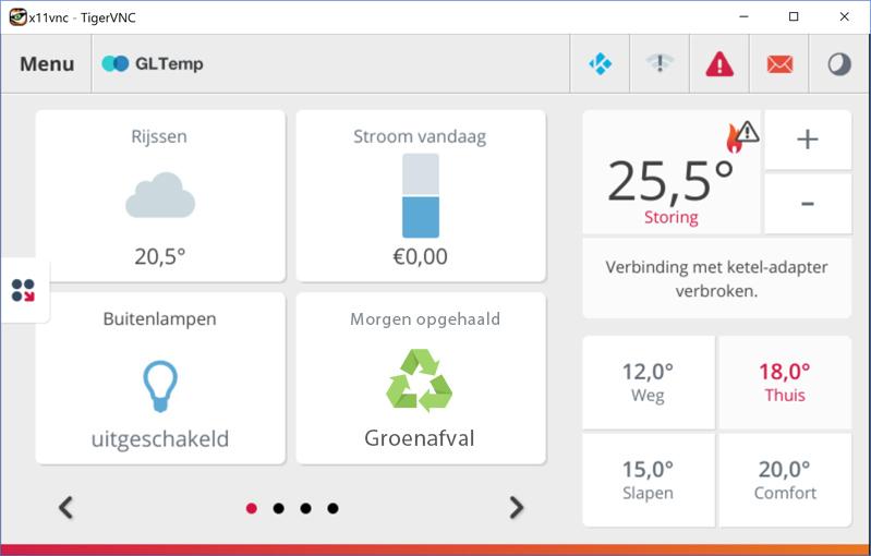

i made a mockup of how i think the afvalwijzer app should look like:
The color of the icon is dependant of the kind of garbage. It only gets this state the day before around 17 o clock. When there is no upcoming garbage, the icon would be gray so it's clear that there is no attention needed. With plastic it is orange etc.
This is how it looks in dim state. When there is no upcoming garbage, then no icon/text. Otherwise a gray icon with the right container.
Multiple containers together? Then a text like "Grijs & Plastic".
What do you guys think?
