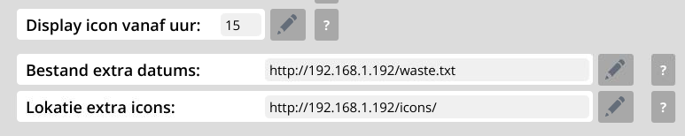

I started implementing a file with extra waste dates to be added to the waste provider data as requested here on this forum but ended up with custom categories and icons as well.
With this you can basically use the app not only for waste dates but also for any sort of calendar reminders, birthdays, wedding dates, whatever......
The extra files can either be hosted on any webserver or placed locally on Toon.
Result looks like this (some snippets):
When you want to store files locally on Toon use "file:///root/waste.txt" for instance instead of "http://192.168.1.192/waste.txt" in the config screen.

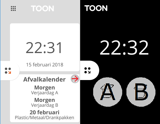

or "A" through "Z" for custom icons and descriptions (use capitals), shown from midnight to Midnight
or "a" through "z" for custom icons and descriptions (use capitals), shown using the 'display from hour setting'

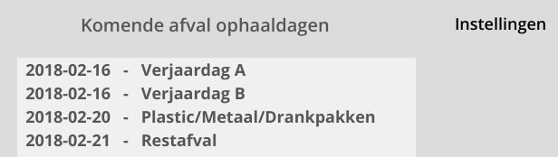

In this example the file with dates is called waste.txt on my webserver and contains this:
2018-02-14,7
2018-02-15,7
2018-02-16,A
2018-02-16,B

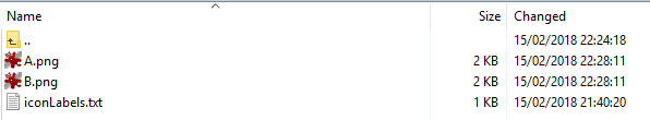

If you want to use custom icons these should be placed in the folder mentioned in the configuration screen and named A.png, B.png etc.
This same folder should also contain the file "iconLabels.txt" with custom descriptions in JSON format.
In this case the file iconLabels.txt contains
{"A": "Verjaardag A", "B": "Verjaardag B"}
icons folder on the webserver containing this:
When creating your own icons you could start with the existing ones from the ../wastecollection/drawables folder.
Create png files with size 126 x 126 pixels, and make sure you make the background transparent otherwise it doesn't look good on the dim screen.

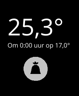

I made a small change in the function updateWasteIcon to show the icon from ~17:00 onwards (ThermostatApp.qml):
		var now = new Date( (new Date)*1 + 1000*3600*7); //current date/time plus 7 hours to show icon from 17:00 the day before onwards
@Ierlandfan: I like the idea to make a formula for the correct 'waste days' but we still need to edit special dates (holidays) in the code to make it 100% correct.
I am leaning towards the idea of putting the calendar in a separate text file which you can easily update without the need for restarting qt-gui (could be a local file on Toon or a file on your webserver)
EDIT 19/4: first bug found: waste icon isn't removed properly the next day, fix being tested.....

- fix for removing the icon after 24 hours
(The function updateWasteIcon in ThermostatApp.qml was lacking proper initialisation of the variables which caused the icon to stay on screen if the next day was not a waste day.)
- waste icon is now shown from around 18:00 the day before (see post above) and is removed same time next day

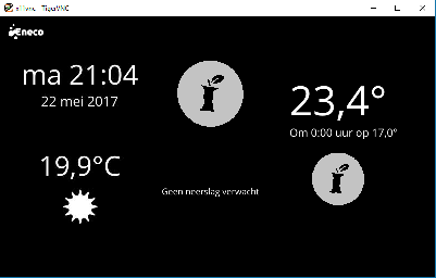

The app contains a tile showing the first three waste collection dates, in dim state a big icon is shown for the specific type of waste that day. On days without waste collection the tile is empty in dim state.
The icon in dim state is shown from 18:00 onwards the day before, for folks who put their waste on the street the evening before.
Dates retrieved from the internet are stored in /var/volatile/tmp/wasteDates.txt
Each day at 18:00 the app is checking for new dates and whether an icon has to be shown, the path to the icon is stored in /var/volatile/tmp/wasteDateIcon.txt

Because I hate empty spaces on Toon in dim state :D I also tweaked the thermostat mod posted earlier. This mod will display a big waste icon underneath the temperature in dim state. You probably guess that the url for the image is taken from /var/volatile/tmp/wasteDateIcon.txt. This icon is update daily at 18.01 to allow the tile to refresh the data first. If you prefer this mod than of course you also need to install the wastecollection app but you don't need to put the waste collection tile on any of your homepages. For backwards compatibility I also kept the javascript waste date option but that value will be overwritten by the wasteDateIcon file if exists.
I made changes to two thermostat app files: ThermostatApp.qml and ThermostatSidePanel.qml
I added wasteCalendar.js with the actual data for waste collection at my place and the icons in the drawables folder.
All changes made to the two system files are clearly marked with '//waste display start' and '//waste display end' lines.
To make the screen more balanced I am showing the temperature a bit higher to make room for the waste icon. If there is no Icon to show the original position is used.
