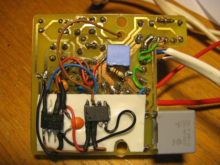

Just for those who are interested in the hardware part:
I have changed the code in my X10 receive unit in such a way that it reacts (transmits) to a status request and also as a result of a button push.
It transmits the data on one of the PIC 16F630 pins, just as ones and zeros. The data is picked up by a second PIC (8 pin 12F683) which only has the task to translate these ones and zeros to the 120kHz puls bursts required by X10 units. Actually, the transmitted X10 data is picked up by the unit and results in the light to go on or off (so the buttons are no longer controlling the light directly).
One of the important things is to have a transmit burst frequency that is as close as possible to 120kHz. Using a Xtal to accomplish this is making the design expensive and bigger. I used a startup routine to calibrate the clockfrequency of the PIC12F683 (this frequency can be changed in the firmware). I used the 50Hz netfrequency as a reference (the net frequency is very accurate!!). This results in an output frequency that is within 2% of the desired 120kHz.
Another impovement is the output driver. I changed the bipolar transistor driver with an integrated one that uses mosfets: Microchip TC1413.
I did some testing and the bidirectional set up works fine. I only have to add the dim-bright transmissions.
Unfortunately I do not have the possibility to do SMD boards, otherwise it would have fitted in the same space as the "receive only" unit.
Han Alink

Hello,
I added the dim/bright transmisions and the unit is fully operational now. One of the things I notice now is the slower reaction to the button commands. Transmission of an X10 On command takes about 900ms (2 times 22 cycles for the address and 2 times 22 cycles for the function, 6 cycles in between). My units react already when the first function is received, so this means a reaction time of about 700ms.
I'm wondering how the Xanura units are doing this. These units are also transmitting button pushes. But I do not know if the transmitted X10 functions are also used as an input for the units to react on. Can somebody tell me if also the local dim and bright commands are transmitted? And how long does it take fo those units to react to a button push?
I added the additional hardware for the X10 transmit function to an existing "receive only" unit. It doesn't look very nice, but I managed to build it in the same space:
You can see the additional PIC, the driver and the additional 330nF capacitor for delivering enough power during the transmit cycles.
