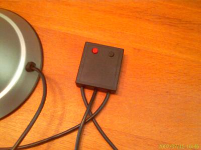

I have build my own "snoerdimmers" See picture.
They can be X10 controlled and locally controlled (ON/OFF/Dim/Bright)

That looks really good!! Better then the most X10 stuff for sale, IMHO.
Do you want to share the schematics?
And a silly question maybe, but why does it have 3 wires?
Re: Wire dimmers available?
Yes I'm willing to share the schematics (let's talk about that via e-mail).

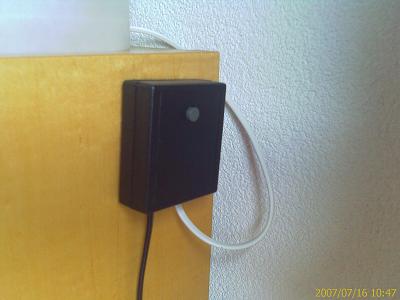

I have 2 lamps connected to the unit. The 3rd one is for the 220V input. Here is another picture (of another unit, with one pusbutton for local control).

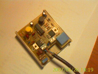

The unit is based on a PIC (16F630). The casing is from PacTec (Farnell). The switches are microswitches with a cap, pcb mounted).
Here is a picture of the pcb (this is a screen controller with 2 triacs, but the dimmers look simular):
