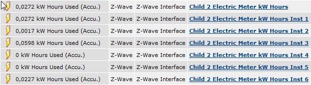

I have the same regarding wrong totals. Didn't wanna say anything cause I haven't really had time to check again with larger loads:

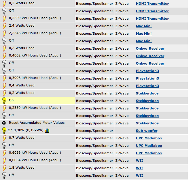

In the screenshot:
- All outlets seem to be off although the current usage is > 0W, this sounds strange right? I can assure you the outlets are actually on.
- The total usage of the switch is reported to be 0,2W, however the individual outlets report 0,2W, 2,4W, 0,2W, 0,4W, 0,7W and 1,8W which make a total of 5,7W.
The reported value of the individual outlets looks OK. Although I did not check what a Plugwise Circle reports for these devices.
Note: The sub woofer is connected to a Plugwise Circle.

Is your HDMI Transmitter on Inst 1?
I think this part (from Digit) looks like the total just shows Inst 1:
Re: Smart node (nuon) with homeseer
Yep
