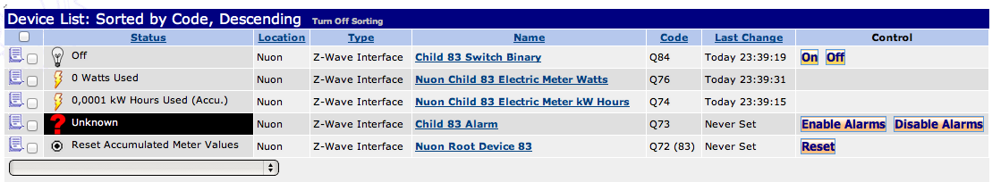

Some Update about Homeseer support.
Homeseer will create 5 devices for the Nuon single device. See picture.
Association with other device or Homeseer is not possibile..No groupes. (I think this is a Homeseer problem)
This means no two way communication.
Error - To add an association, a group number is required. Make sure your device supports association groups.
Also the usage will be not updated automatically.
When auto Poll is active device status and the usage will be updated on the set time.
I don't know what the Alarm devices are doing in Homeseer.
The led of the device very annoying...is like a spinning UFO in the night.
Sometimes it will start spinning don't know why.

With two way communication I'm mean the devices will not support to Homeseer when the device is locally switched On/Off. This will be done after the Poll time.Digit wrote:Hi Enver, why do you say there is no 2-way communication?
(I assume you can switch the node on and off..)
In my vocabulary, 2-way means that I can read and write to a device. Both are doable (if my assumption above is right).
The power strip also has this annoying green spinning light; imagine having a couple of those UFO's in your house, what were they (Greenwave) thinking???
Giving the 'coolness' an extra boost? I agree, the UFO's are over the top.
One last question: where can I find information about radio strength? I'd like to know this for my NUON power strip too.
In the Device config there is support for this association..This means device can do this.
Homeseer is not supporting this well. This is a very complex device and need some time before this is implemented in all software.
Vera and Fibaro HC2 are also showing the same problem.
Radio strength can be calculated in the neighbour status
Place the device close to another device and optimize.
After the optimize check the number of the neighbours

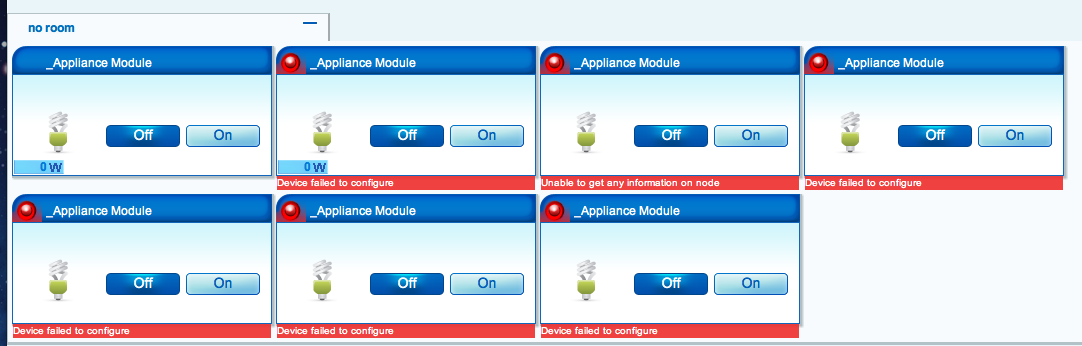

Re: Smart node (nuon) with homeseer
Vera screenshot
Not all the devices are showing usage..
Don't know whey some devices have the red dot.
I can switch them fine.
- Nuon6.png (35.86 KiB) Viewed 20358 times

Huh 7 devices, so thats one parent device and then 6 childs? And configuration failed on all of them?TANE wrote:Vera screenshot

it's not my topic..
First device is for all on/off
Connection is working fine I can switch every device On/Off..Other settings are having problems.
check what this device can do...
