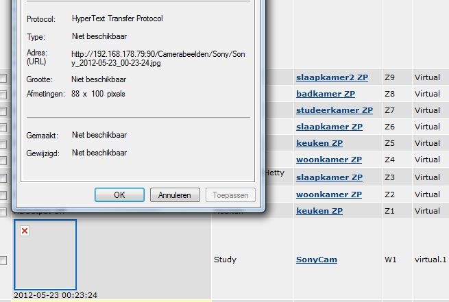

Indeed in the URL something seems wrong with "/" and "\"
During the event no pictures are written to: C:\Program Files\HomeSeer HSPRO\html\Camerabeelden\Sony
The hyperlink of the picture in the HomeSeer homepage: http://192.168.178.79:90/Camerabeelden/ ... -21-16.jpg
But there is no picture in the HomeSeer-homepage.
Homeseer Logging after refresh HS-Homepage:
Web Server Error 404, cannot serve file: C:\Program Files\HomeSeer HSPRO\html/Camerabeelden/Sony/Sony_2012-05-15_01-21-16.jpg
Thanks for help

When running the event No picture is written in the directory.
In the directory C:\Program Files\HomeSeer HSPRO\html\Camerabeelden\Sony No picture is written.
Running the event makes the right url in HS-homepage.
But no picture appears in the HS-homepage (Because it it not in the directory). Debug = 0

The Homeseer homepage.
The event does not write the picture in the Directory and NOT in the HS-homepage.
Directory: C:\Program Files\HomeSeer HSPRO\html\Camerabeelden\Sony
Thanks for help.
Thanks for help.

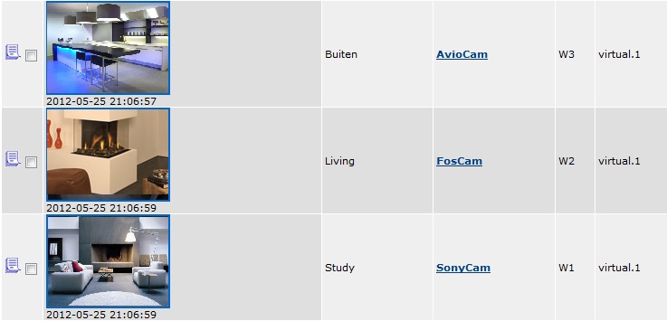

- Homeseer homepage
- SonyCam.JPG (53.48 KiB) Viewed 8616 times
Best regards, Verkenner
YES ! WORKS !!
Yes, the webcamscript_03.E works.
After many hours of debugging, testing and engineering I reinstalled the original version of DJ's webcamscript_03e.
Now it works with 3 different IP-camera's (Sony, Foscam and Aviosys) on Homeseer Pro and WIN7.
("Main","W1|http://user:password@145.44.44.44:89/on ... n\Sony|yes") (extern IP adres)
("Main","W2|http://192.168.178.10/snapshot.cgi?user ... Foscam|yes") (local IP-adres)
("Main","W3|http://192.168.178.22/snapshot.jpg?name ... viocam|yes")
DJ many thanks for the script and help.
Cheers

- HS-homepage
- cam.jpg (48.62 KiB) Viewed 8609 times
