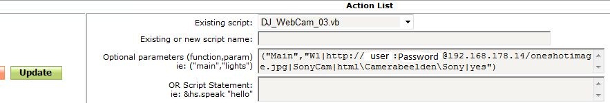

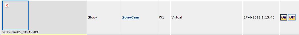

Vrienden, uren getest maar ik krijg het fraaie webcamscript van DJ nog even niet aan de praat. Sorry.
Ik heb het script in een event gezet maar er komt geen plaatje in de Homepage van Homeseer.
Als ik het commando geef: http://user:password@192.168.178.14/oneshotimage.jpg
dan zie ik in de browser de foto wel verschijnen.
Kan het zijn dat plaatjes van de webcam worden weggeschreven naar de Directory \Homeseer 2\html\ ??
Hoe krijg ik ze dan weggeschreven naar \Homeseer PRO\html\ ?
Waarom komt er na het starten van het script geen foto in de homepage van Homeseer?

geen plakplaatjes
Thera are no pictures in de map: homeseer pro/html/camerabeelden/sony

I don't think /Homeseer 2/ or /Homeseer PRO/ makes a difference. The parameters seem to be correct. You could, as a test, create the "Homeseer 2/html/Camerabeelden/" folder, just to make sure
In the script you can change the variable 'strDebug' from 0 to 1 or 2 ('2' won't save an image but provide a lot of debugging info in the HS Log)
Can you run that and reply with the debugging info?

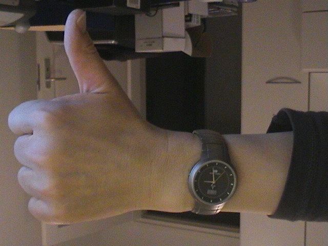

Hey, wait... looking at the background, I think this image has to be flipped vertically to make it correct, right?
So how to interpret the direction of the thumb??

Yes
You did find it.
My Sony is standing on my desk but normaly it hangs on the ceiling.
On my desk the video is flipped.
Actuality I made the picture pointing my thumb down.
And I turned around my watch 180 degrees.
Reason for that all was that I wanted to show the time is nearly 21 hour.
Next time I will turn around the frontdoor of my office.

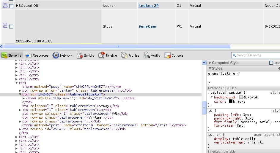

Verkenner,
The easiest thing to do is use Firefox or Chrome and right click the missing image. Now click "Inspect Element" or something similar.
With Firefox you then have to select "HTML" on the bottom right. That should now show the HTML code for this image.
You'll be able to see if there's some URL problem.. Feel free to share that part of the HTML source code of your device page that shows the missing image.

Installed Chrome on a dedicated PC.
Made a screencopy (attached).
With Chrome in homeseer homepage I do not see script for the picture. Suprising.
Do not know why there is no picture in the homepage.
Thanks for help
Verkenner

What you can do: in the script, change 'strDebug=0' to '=2'.
Then it won't capture/save images but write entries to the HS log describing exactly what it wants to do. Can you share the log entries?
BTW, if you capture images without the date/time (fixed filename) you can manually set the W1 device to show that image. Here's how that should work in the HS 'Control Panel' page:
&hs.setdevicestring "W1","<img src='/Camerabeelden/SonyCam.jpg'></img>"

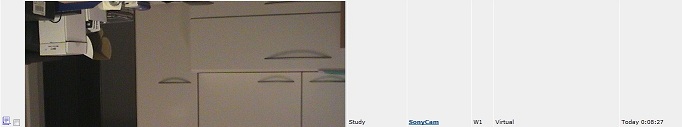

Hi DJ, thanks for help.
Yes, the 'oneliner' in CONTRO PANEL Intermediate script command works.
The picture is very big, 640*480 pixels, but it appears in Homeseer-homepage.
Command:
&hs.setdevicestring "W1","<img src='/Camerabeelden/Sony/SonyCam.jpg'></img>"
Perhaps it s possible to shrink the picture.
Of course I like the time/date stamp to make the pictures unique.
Thanks.
Command:
Thanks.
