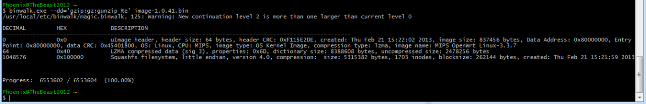

Use binwalk to determine the structure of the bin file:
user@ubuntu:~/stretch$ binwalk image-1.0.41.bin
DECIMAL   	HEX       	DESCRIPTION
0         	0x0       	uImage header, header size: 64 bytes, header CRC: 0xF115E2DE, created: Thu Feb 21 06:22:02 2013, image size: 837456 bytes, Data Address: 0x80000000, Entry Point: 0x80000000, data CRC: 0x45401800, OS: Linux, CPU: MIPS, image type: OS Kernel Image, compression type: lzma, image name: "MIPS OpenWrt Linux-3.3.7"
64        	0x40      	LZMA compressed data, properties: 0x6D, dictionary size: 8388608 bytes, uncompressed size: 2478256 bytes
1048576   	0x100000  	Squashfs filesystem, little endian, version 4.0, compression:  size: 5315382 bytes,  1703 inodes, blocksize: 262144 bytes, created: Thu Feb 21 06:21:59 2013

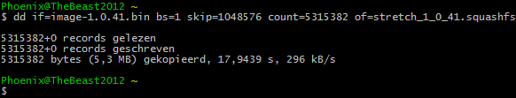

The use dd to extract the squashFS filesystem using the offset from binwalk:
user@ubuntu:~/stretch$ dd if=image-1.0.41.bin bs=1 skip=1048576 count=5315382 of=stretch_1_0_41.squashfs
5315382+0 records in
5315382+0 records out
5315382 bytes (5.3 MB) copied, 13.8922 s, 383 kB/s
Then unsquash the filesystem.

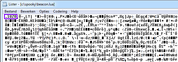

Ps. as a sidenote...it seems SOME LUA SCRIPTS look "compressed" (or scrambled)!
For example "\usr\local\plugwise\rest-interface\modules\configuration\beacon.lua", it's not plain text anymore, all headers start with "lUZ" or somesort, could be compiled data....
I tried some LUA decompilers, but with no luck, i get an error about a illegal char or so...:
Lua 5.1 Decompiler: http://winmo.sztupy.hu/luadec.html
Easy LUA Decompiler (java based): http://forums.kleientertainment.com/sho ... Decompiler

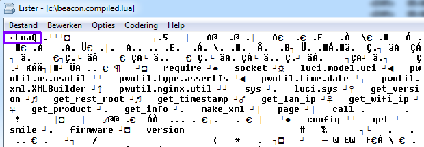

--- EDIT ---
I've used a online converter here: http://mta.dzek.eu/compiler/ to see if the headers are the same if i put a LUA script from the smile in it, and they are not..... :D , so this is really a "mistery" datablob... :mrgreen:
--- EDIT ---
Hmmph, there could be a chance if they use their "own" LUA Reader of somesort :roll: , there is a file to read those LUA script i think....it's here in: "\usr\bin\pwlua"

Post-IT wrote:Use binwalk to determine the structure of the bin file:

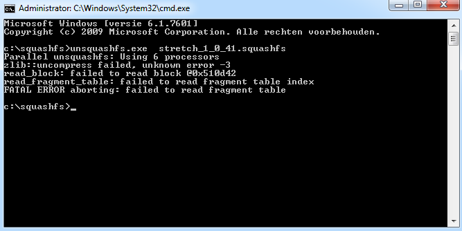

Yeah, most steps work in Cygwin too!, except unSquash 4.0 doesn't support LZMA :twisted: (4.2 does, but cannot be compiled in Cygwin)
More can be read here: http://blog.403labs.com/post/4478700725 ... quashfs-on
Unsquash for Windows: http://fragilematter.blogspot.nl/2010/0 ... aries.html

I think you are missing liblzma and zlib libary which I have by default when installing squashfs-tools on ubuntu:
user@ubuntu:~/stretch$ apt-cache depends squashfs-tools
squashfs-tools
  Depends: libc6
  Depends: liblzma2
  Depends: liblzo2-2
  Depends: zlib1g

Yes, also LZMA needs to be installed...i haven't tried it, because SquashFS tools v4.2 cannot be compiled on Cygwin, the build breaks!, you need to alter some data in the .h or .c source's (like the patches (.patch) on the site where you can download SquashFS tools for windows) to make it a proper build in Cygwin. The only thing is...that the patch for v4.0 doesn't work for v4.2, so it has to be rewritten, and it seems the author hasn't done it yet...
But i will install a VM soon!

I think pwlua is a compiled binary which is used to parse the lua files through and thus contains the decryption algorithm or obfuscation hash.
I'm almost thinking about ordering a separate Omnimaboard to do some testing on using the 1.0.41 image. It seems there is a compiler on the system.
