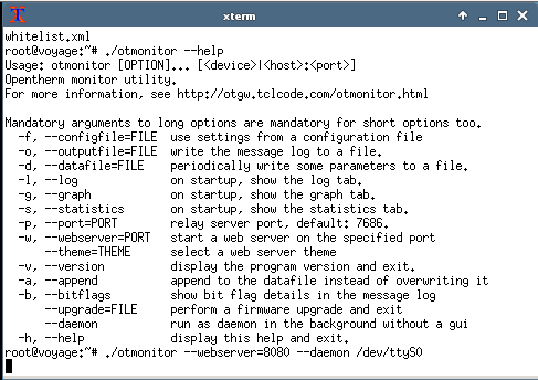

It's indeed Linux X86, but same error

It only starts when running a Xwindows

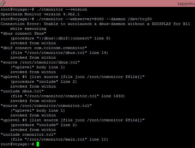

Posts: 2035
Re: Opentherm Gateway 4.0 alpha/beta testers wanted
That's a completely different error. Why are you running this as root? That should not be necessary. (You may have to add the user to a special group to allow access to the serial port.)
Posts: 2035
Try 4.0b2.2. That doesn't crash in case of dbus problems (of course you won't have dbus control of the application in that case).

hvxl wrote:That's a completely different error.
You're right, I was also trying to use the dbus... but that gave the same error as otmontior..
sappien
Posts: 38
Joined: Fri Oct 16, 2009 11:11 am
Post by sappien »
hvxl wrote:Try 4.0b2.2. That doesn't crash in case of dbus problems (of course you won't have dbus control of the application in that case).
It's working.. Now I've got to figure out why dbus isn't working ;)

dbus-send --print-reply --dest=com.tclcode.otmonitor / com.tclcode.otmonitor.Command :PR=A[/b]
Failed to open connection to "session" message bus: Unable to autolaunch a dbus-daemon without a $DISPLAY for X11
When I'm using eval it starts without the Display error
eval 'dbus-launch --auto-syntax' "dbus-send --print-reply --dest=com.tclcode.otmonitor / com.tclcode.otmonitor.Command :PR=A"
Error org.freedesktop.DBus.Error.ServiceUnknown: The name com.tclcode.otmonitor was not provided by any .service files
Any idea? I've tried creating .service files, but I'm unknown with dbus, so just messing around :roll:

OK, that appears to work. I wasn't aware of dbus-launch, but it seems you can use it to start otmonitor with a session dbus:
dbus-launch --exit-with-session ./otmonitor --webserver 8085 --daemon &
After that you can control otmonitor via dbus, even from another shell running under the same user.
Note: I think dbus-launch was the key, not eval.

Otmonitor is running with the dbus-lauch, but connecting to it with dbus is still not working :
without eval I still get :
with eval :
--edit--
Is the name com.tclcode.otmonitor setup by otmonitor, or must I configure this manually?
Posts: 2035
It's hard for me to come up with different suggestions since the previous one worked for me (on a raspberry pi).
You could try:
$ dbus-launch > /tmp/dbusenv
$ ./otmonitor.ahf --daemon --webserver 8085
And then in another session:
$ . /tmp/dbusenv
$ dbus-send --print-reply --dest=com.tclcode.otmonitor / com.tclcode.otmonitor.Command :PR=A
The com.tclcode.otmonitor name doesn't require any manual configuration.

unfortunately... :cry:
I will try it on a fresh normal Debian installation.. (now using Voyage debian Linux)
