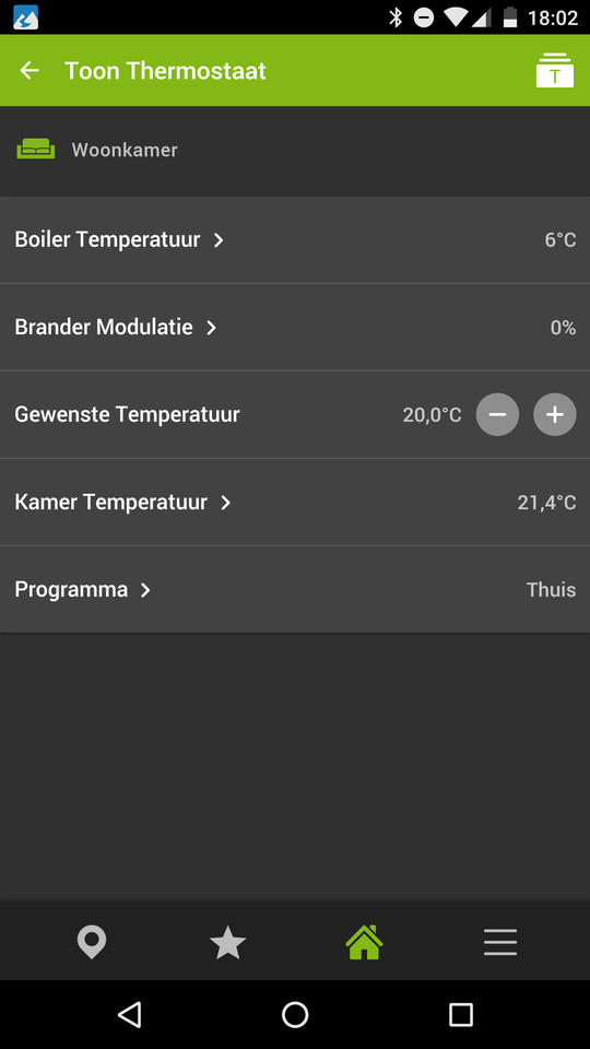

The 6 degrees look like boiler control setpoint rather than a boiler temperature (there are three of them: CH output temp, CH return temp, DHW temp, take your pick
