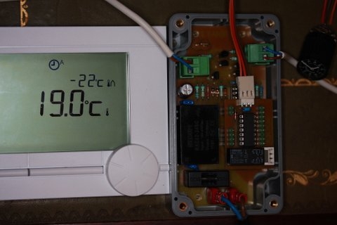

As promised some pictures of my gareway.
I designed a single layer PCB with Sprint Layout and used a switching power supply. (less than .3 W total power consumption)
As my main purpose was to display the outside temperature on the iSense, i also made a piggy back PCB to which i connect the temp. sensor (NTC)
The FTDI cable also connects to the piggy back.

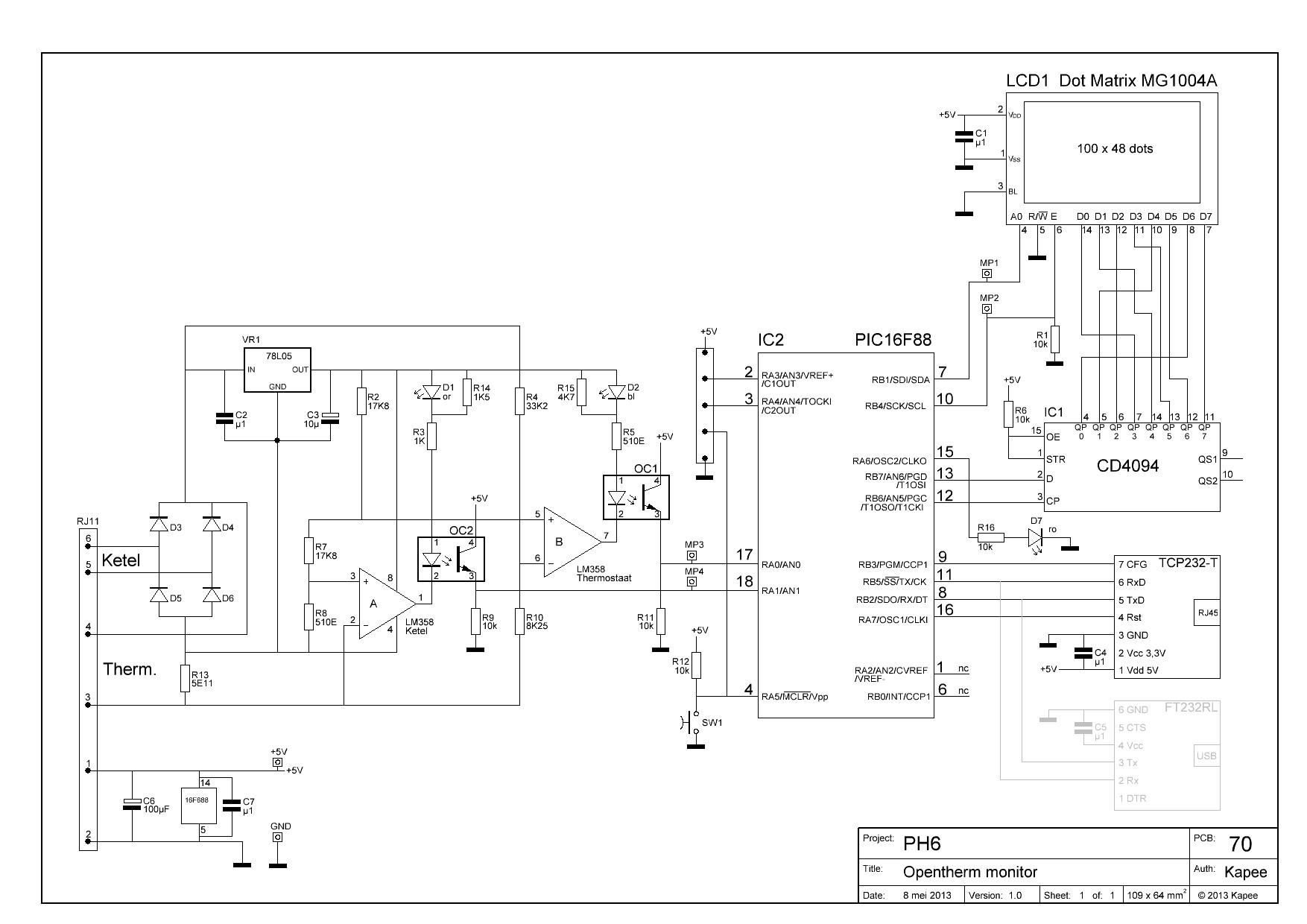

Beginning of 2013 the heater had to be replaced. An Intergas HReco 36 with a Honeywell Chronotherm touch thermostat was the new heater system.
Then searching the internet for possibilities with the new heater, found the tclcode site and wanted to build an Opentherm Gateway by myself as a retired hardware engineer.
The idea arise to build an opentherm monitor with a 6x16 display, but not the complete two way gateway. Some time ago the dot matrix displays were offered at samenkopen.net.
The start was to make a circuit diagram and after that etching and assembling the pcb.
Thanks to Schelte Bron I could get the source file from the gateway firmware. I promised him to show the outcome in this forum.
The last action was adding the firmware for the display, the difficult part was the timing of the time sensitive routines.
Circuit diagram
full size
What is changed in the hardware?
• Replaced the Gateway interface by the Elektor interface.
• Omitted the rs232 and added an USR TCP232-T.
• Omitted the four led’s and added a dot matrix display.
• The connection is done with a RJ12 connector for +5V, 0V, 2 wires heater, 2 wires thermostat.
(Next to the heater there is a kind of hub pcb for signals in the attic, with a.o. water alarm underneath the heater)
Circuit diagram
full size
