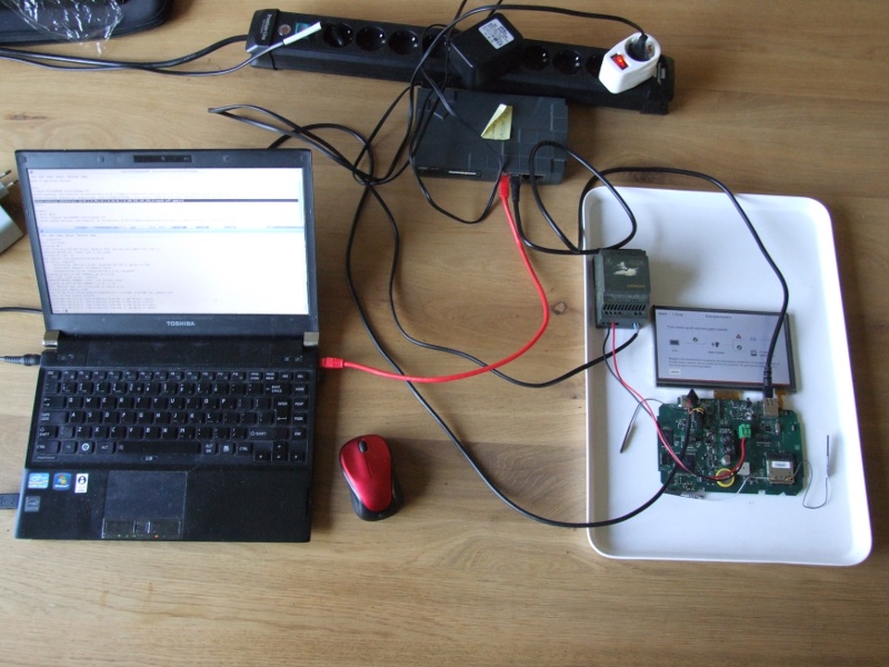

To continue with my resuscitation activities:
The patient's not dead yet ;-).
Today I got my tftpboot setup working and I successfully booted one of the kernels I made with the source tarball of quby's.
Here's the result:

The kernel loads, can read the NAND chip, and then decides that the root filesystem on it is really fucked up beyond any recognition, resulting in a kernel panic.
But that's OK. Not a thing that can't be fixed.
The good News is that kernels built from the source tree actually boot the way they should. This opens new ways for adapting toon to other needs. We can basically add anything we like, from printers to webcams, remotely mounted filesystems, data acquisition hardware, whatever, take you pick.
grtz,
The patient's still in ICU, but stable :-), he's gonna make it.
Last week, one of the forum members sent me a set of mtd dumps, and these turned out to be quite useless. Wasn't his fault, the rootfs, as flashed onto toon, is hard to mount without the right hardware (i.e. nand flash memory). So I sent him a script to dump the rootfs over ssh. That rendered a useful tarball, holding a complete root filesystem with a recent copy of toon's firmware.
The tarball holding the rootfs of his toon, together with a modified linux kernel, could be used to revive my toon (or any other, for that matter). It took some effort, the description of the inner workings of u-boot, nfsd and the combination, on modern linuxes, as found on the internet is less than optimal, let's put it that way ..
The kernel loads via tftp, the rootfs via nfs, from a dedicated set of servers (NFS, DHCP, TFTP) in combination with an old router limited to issuing 1 IP address only.
In case anyone's interested in the details, not sure if I will find the time to post them all, it's quite a long story ...
Now I will need to find a way to turn this rootfs into a flashable file for my toon, that's the easy part, before that I would like to return the rootfs to a more or less virgin state, i.e., get rid of all the data, settings, serial number-specific entries etc.
Me and my big mouth ...
Stripping the rootfs down to an anonymous, virgin, root filesystem turned out to be the easy part. That's done. Toon installs like it should, had to patch
/HCBv2/config/config_happ_scsync.xml manually, but that all works, now I have the whole lot of tiles as presented to "customers only". Just traffic and weather aren't working, known issue.
Flashing the rootfs onto toon is easy. Booting toon from it, that's a totally different kettle of fish.
Will keep trying, playing with bootloader, kernel flags, UBI layout, that sort of stuff. If anyone's an expert on UBIfs and flashing boot partitions on NAND flash, please come forward.

My rig to resuscitate toon: laptop with CentOS 6 + openembedded toolchain for toon, 100MBit router, 24V power supply, toon removed from housing, with serial connection to laptop.
