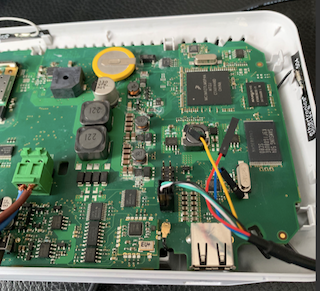

Just to be sure, can you post a photo of your wires connected to the toon? And the boot screen where the boot version is shown?

TheHogNL wrote:Just to be sure, can you post a photo of your wires connected to the toon? And the boot screen where the boot version is shown?
Schermafbeelding 2019-03-09 om 10.01.53.png (54.88 KiB) Viewed 9263 times

You are connected to the correct pins. However, I was not expecting two extra wires. Most TTL adapters have 4 wires (tx, rx, gnd and 3.3v). What ttl adapter are you using and are you sure those are the tx and rx from the adapter?

It looks you have a PL2303, most of time this one is 5v
You need 3v3.
Try at you're own risk this one:
Black wire is GND, connect this one on GnD from Toon.
Green wire is TXD, connect this one on RxD from Toon.
White wire is RxD, connect this one on TxD from Toon.
Can you put the password now in?

TheHogNL wrote:You are connected to the correct pins. However, I was not expecting two extra wires. Most TTL adapters have 4 wires (tx, rx, gnd and 3.3v). What ttl adapter are you using and are you sure those are the tx and rx from the adapter?
It is a USB to TTL converter with a FTDI chipset.
6 wires:
1. Yellow: RTS
2. Black: GND
3. Blue: CTS
4. Green: TXD
5. Red: 5v
6. White: RXD

mAiden wrote:It looks you have a PL2303, most of time this one is 5v
You need 3v3.
No, unfortunately, I can't put the password in.....

Where did you buy this? Are you sure it is 3.3v (as the red power is putting 5v my guess is that your TX is also on 5V)?

TheHogNL wrote:Where did you buy this? Are you sure it is 3.3v (as the red power is putting 5v my guess is that your TX is also on 5V)?
This one is from AliExpress.
Wich one do you suggest?

By the way, you are posting this in the automated rooting script topic... you are using the manual way. :-) My guess is that your cable is wrong, or now with 5v you might have broken the UART on the toon (requering 3.3v).
