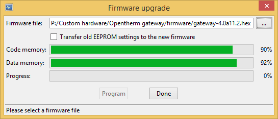

I cannot upload an old firmware with the new otmonitor 4.0b0. The program button remains greyed out after selecting a firmware file.

Post by vanisher »
Just tested, same issue here. (no programming possible)

nlrb wrote:I cannot upload an old firmware with the new otmonitor 4.0b0. The program button remains greyed out after selecting a firmware file.
That's a bug. I'll fix it. Thanks for reporting.
