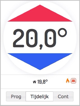

trie wrote:I'm not sure what other users are using for their OTGW interaction?
For two months my OTGW is in production. :P I own the Honeywell Vision Touch thermostat as well and wrote a little script to reset to the program when the override time expires which I set on my phone.
The back-end of my domotica system is self written in Ruby and the front-end is written in PHP for back-end calls and HTML5/jQuery for the GUI. I disliked all the interfaces I found on the Internet, I want it to be sleek and modern, so I wrote everything myself:
The Central Heating Mode, Domestic Water and Flame status are realtime. When the boiler pressure drops below 1.2 atm I get a warning in the status bar. Therefore I don't have to run upstairs and check every month (I'm getting lazy with al this automation).
My girl LOVES it! :D She can set the thermostat higher with the comfort of lying under her blanked at the couch watching cheesy TLC shows :lol:

Joep that UI is awesome! Are you willing to share your code?

The code is custom build on my selfmade domotica system. It's not a framework, so you have to change and fiddle a lot to make it work on standard systems or other home-brew back-ends. Shown screen is just the OTGW part, I have everything incorporated, from lights, door-sensors, weather station, movie watch list information to Sickbeard upcoming TV-shows. But showing screenshots is off topic.
I would like to share it with the forum members here, but I used and edited artwork found via Google and don't have the license for it, so I think I cannot make it public. :cry:
