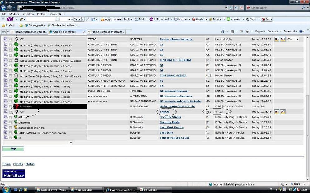

oh oh , just a little problem : the device v11 is not updated.
with the new installation it has never been updated (on the other pc it was)
i did :
1) changed address of device and setting in vb script
2) changed type from virtual to others
3) deleted and created again
not solved.
Alexander
Posts: 1532
Re: License plate recognition
Post by Alexander »
Lorenzo,
What do you mean with not updated? The value doesn't change (other license plate) or the last update column with the time & date.
No log errors?

Posts: 1532
Post by Alexander »
change device to status only. That will properly not fix is, but its a better choose.
does the file c:\windows\ocrLPR.txt exist and if so what is the content?
