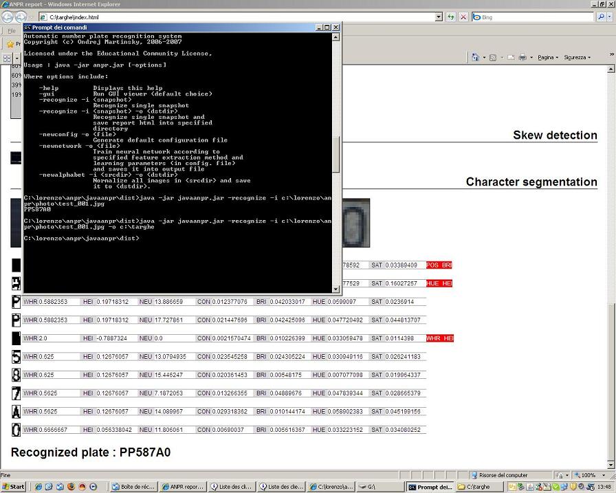

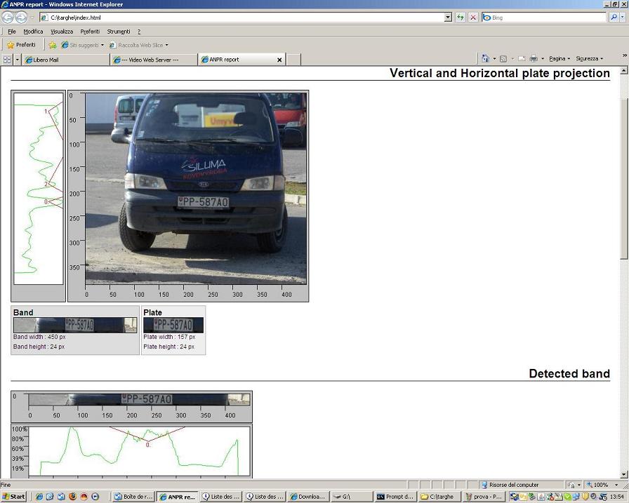

Re: License plate recognition
Hi guys , I GOT THAT !!
i found a FREE to use Java application that works like a charm.
you can use by command line
you have a report as html file
i was thinking :
homeseer,
security cam that send email with car picture
picture is saved and processed by java application
html report contains a field with plate number
extraction of this number
this number in compared to "friend" numbers , if not send a warning to mail , sms etc......
see screenshot 1 and 2
download here : http://sourceforge.net/projects/javaanp ... p/download
i was thinking :
homeseer,
- prova2.JPG (78.99 KiB) Viewed 29333 times
- prova.JPG (106.9 KiB) Viewed 29333 times
