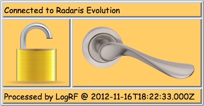

Inspired by Websockets and MQTT I created the following to monitor and control my front door ... I believe the pictures say it all ... Ohh when you click on the door handle it unlocks the door ... I think it is very cool

Now available on the iPhone - just as an example that it works ... Introducing authenticated mqtt messages ...
