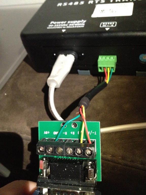

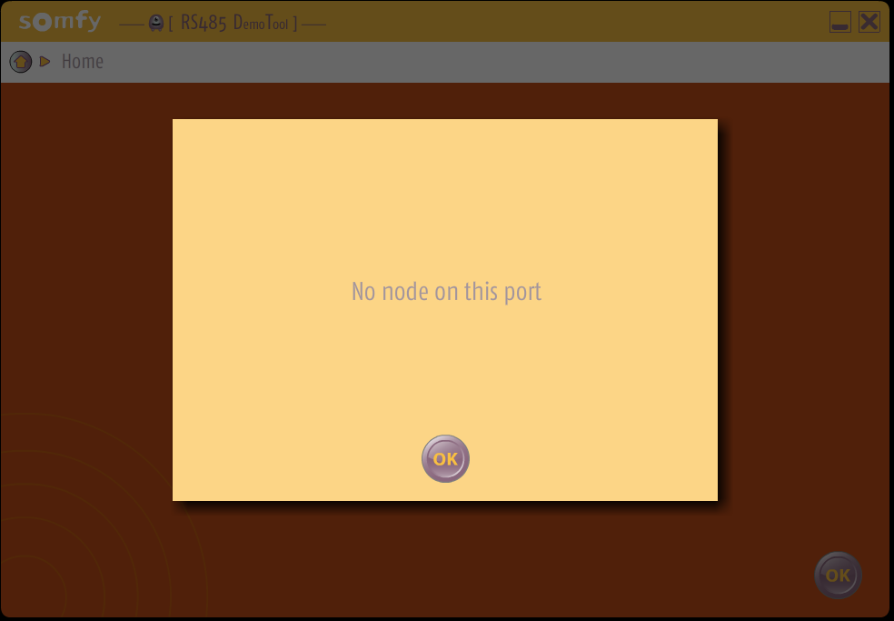

@labium
sorry to bother you again, but i can´t get this bloody interface working...
I have just received the hexin converter and connected it to the somfy transmitter, but i still get this "no node on this port" message with the somfy demo tool.
I am really becoming desperated...
Have you tried to control your blinds with the demo tool as well?
If not, how did you connect to the rts transmitter?
Thanks again...
Thanks again...

Re: somfy rts 485 transmitter art 1810803
this demo tool i dont know, where did you download that ? then i can check the demotool.
you can download it here: http://www.somfysmarthome.co.uk/Resourc ... 20V1102.7z

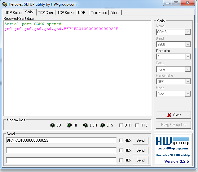

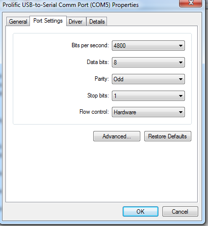

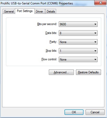

first no flowcontrol !!
your wiring is correct , the demotool works, only i have on my windows 7 computer the following comportsettings: 9600 8 none 1 and no flow control. i think the demo tool changes these values
seems odd but the demotools works with these numbers. he gets my node id. first no flwocontrol !
http://www.hw-group.com/products/hercules/index_en.html is the terminal program with which i made my first contact with the somfy transmitter, use tab serial fill in the somfy comspecs with no flowcontrol . handshake no mode free
send hex command .(check the checkbox )and you should get a response in hex
"the are you there "command is in hex :
BF74FA010000000000022E (ie: getnodeadress of somfy device, could also obtain nodeadresses of othersomfydevices)
the answer is also in hex .
if this doesnt work change +/- wires nothing bad happens
please let me kno if you succeded.
did you try the dct locks to see if the transmitter works
Hi labium,
thanks a lot for your patience, but i don´t get a connection to the transmitter...
What do you mean with "did you try the dct locks to see if the transmitter works?
Which functions does this blue hand whell beside the plug have?
If i switch it i.e. to 1, press the programm button on the radiocontrol (until the shade joggles) and then press the button beside the blue hand wheel, the shade also toogles...so i think, the transmitter sends something to the shade.
I tried it also with your mentioned terminal program with many different connection settings (speed, etc)...it simply doesn´t work and there is also no answer from the transmitter...
I really think, that this box is faulty...
