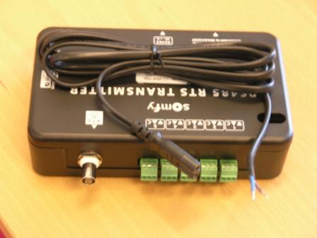

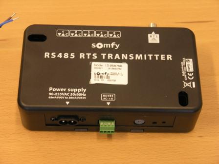

today received by post
no drivers , no software. no power plug.
it is a simpel model in comparison with the american model which has a rj45 for the rs 485 connection such as to be bought by the av oulet store in the usa
there are 4 pins for the rs 485 connection
see picture 1
pin 1 not to connect, pin 2 is rs 485 bus + ,pin 3 rs 485 bus - ,and pin 4 is ground.
i have a rj45 to serial converter , bought for the powermax pro programming.
which pin should i connect to what pin on the rj 45 plug ?
or do i need this for connection to a windows pc ?
see picture 1

- back or front

- front or back

Re: somfy rts 485 transmitter art 1810803
1 week a functioning rs485 rts transmitter with homeseer .
it works with homeseer
it has a perfect transmitter range: 3 stocks with concrete layers , no problem in reaching every somfy motor (12) in the house formerly controlled by 3 telis 4 remotes.
commands doesnt disappear in the air.
still some questions about some commands mentioned in the installation guide and no answer from somfy or reseller:
the open-program frame what is its specific use ?
the telis 4 rts remotes used until now have two motor program modes:
1 press up and down button simultaniously: you can set begin , end and favorite position of the roller shade
2 press program button on rear to let the motor learn new remotes eg the rs485 transmitter.
and the motor can be brought back in factory setting by disconnecting the power in a special manner
are the altus motors able to be programmed to feed back there respons or positon ?
labium
