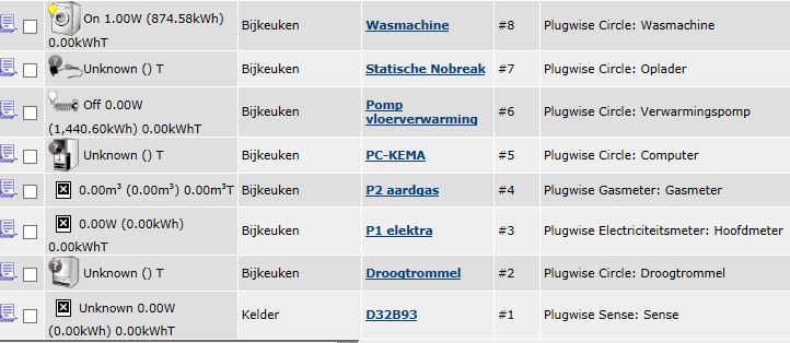

PlugWise Plug-in 2.1 and Plugwise Source 2.23
Several weeks many problems after installing Plugwise source 2.24, very instable
Now Plugwise downgraded to version 2.23 (never install beta !), HomeseerPRO 2.5.0.81, HS-plugin 2.2.1.0 (Copied statistics.xml and switch.html to ..Plugwise/Plugwise Source/www ).
Plugwise webserver is running ( http://localhost:8080/)
In HS-logfile: 28-4-2014 22:16:14 Plug-In Found plug-in: Plugwise, version: 2.2.1.0
Now in Homeseer some Plugwise devices are corrupt.
What can I do?
What can I do?

Re: PlugWise Plug-in 2.1 beschikbaar
All devices in HS deleted bij hand.
And Plugwise Source REinstalled. Incl. Drivers
Now all in Homeseer all Plugwisedevices are back But NOT Sense.
Sense has gone in Homeseer.
