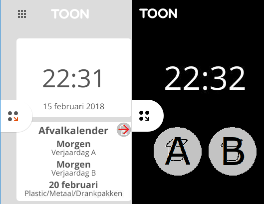

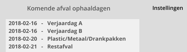

Result looks like this (some snippets):

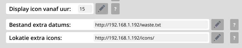

When you want to store files locally on Toon use "file:///root/waste.txt" for instance instead of "http://192.168.1.192/waste.txt" in the config screen.

In this example the file with dates is called waste.txt on my webserver and contains this:
2018-02-14,7
2018-02-15,7
2018-02-16,A
2018-02-16,B

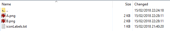

If you want to use custom icons these should be placed in the folder mentioned in the configuration screen and named A.png, B.png etc.
This same folder should also contain the file "iconLabels.txt" with custom descriptions in JSON format.
In this case the file iconLabels.txt contains
{"A": "Verjaardag A", "B": "Verjaardag B"}
icons folder on the webserver containing this:
When creating your own icons you could start with the existing ones from the ../wastecollection/drawables folder.
Create png files with size 126 x 126 pixels, and make sure you make the background transparent otherwise it doesn't look good on the dim screen.
