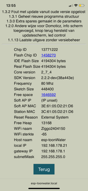

Hello everyone,
I have a problem with Toonwater, after a few days I can no longer access the wemos via the ip address.
at these moments Toon is still connected (with the wemos).
but then Toon also spontaneously loses the connection, a hard reset of the wemos is the solution.
Does anyone have a problem with this or a solution?
Attached screenshot of the wemos info page
Info pagina Toonwater

You are using a very old software. In the old version the wifi is nit reconnecting when losing the wifi. In the newer versions it is attempting to reconnect. So update to the latest version.

oepi-loepi wrote:You are using a very old software. In the old version the wifi is nit reconnecting when losing the wifi. In the newer versions it is attempting to reconnect. So update to the latest version.
where can i find the latest version?
I have version 1.3.15 is this not the last one?

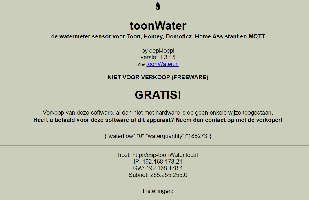

Ok, from what i understood from your screenshot was the very old version. I guess you have only send part of the text there. If you have set the static ip and the wifi is lost, the unit will try to reconnect automatically. Try to run the upgrade with the latest file, just to be sure.
Also make sure that you do not have another divice in hour network assigned to the same static ip.

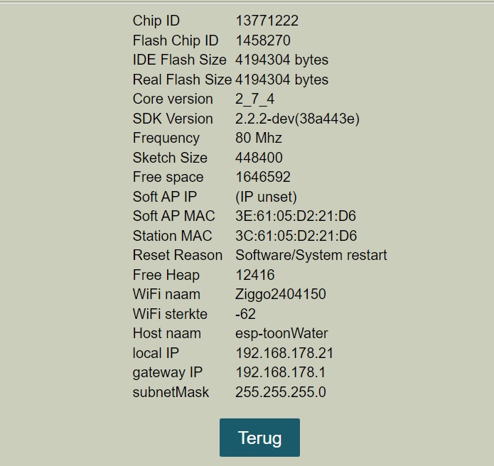

oepi-loepi wrote:Ok, from what i understood from your screenshot was the very old version. I guess you have only send part of the text there. If you have set the static ip and the wifi is lost, the unit will try to reconnect automatically. Try to run the upgrade with the latest file, just to be sure.
update done again (see attachment for result)
the IP address (21) has been reserved for Tooon water. so this must be good.
I also don't see any apartments that come close with this ip address (in the router)

Still have after the latest firmware that sometimes I can't connect. (with the Wemos)
I can also see it in Toon that the graphs become gray

Krisrock wrote:Still have after the latest firmware that sometimes I can't connect. (with the Wemos)
Maybe the wifi at the wemos is not stable?

The Wemos is 2.5 meters away from the router.
Surely the reception should be good then?
info from the wemos: wifi strength -66
will look into getting an external antenna for the wemos or will this not help?

Krisrock wrote:The Wemos is 2.5 meters away from the router.
The strenght of -66 is not the best. Maybe your wemos has a fault.
