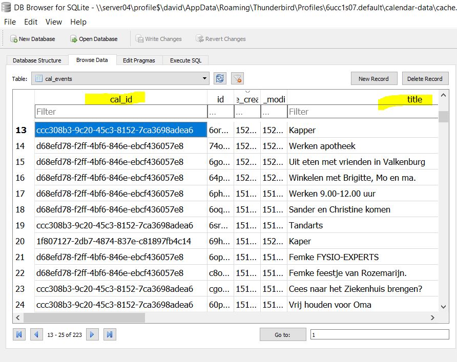

Hi Toonz,
By using thunderbird with the Lightning addin, the calendar events are already placed in a sqllite3 database at the following location:
% AppData% \ Roaming \ Thunderbird \ Profiles \ YOUR_PROFILE \ calendar-data \ cache.sqlite
By readingout this file with a php application, Toon can show the extra calendar in the wastecalendar app.
I'm looking for a field in the database that can be used for the icons (number) information.
Calendars of multiple users can already be recognized by the field "cal_id"

Re: Toon app: Afvalwijzer
ok, but this processing needs to be done on your PC/webserver as Toon has no browser capabilities.
Would be nice if you can automate this process to have a text based calendar file (flat text, xml, ical format, whatever) available on your own webserver which can be retrieved by Toon.
