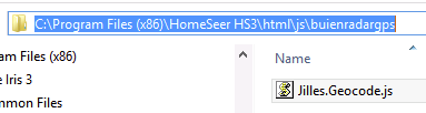

UPDATE: Just saw that after the restart the address was not checked as active. Changed it and I am back with the error in the log:
File does not exist: C:\Program Files (x86)\HomeSeer HS3\html\js\buienradargps\Jilles.Geocode.js
But file is there: Another odd thing: when I enter LAT and LON it shows OK, when I try to edit the values the popups are switched arround. Clicking on the LAT, give the popup for LON and vice versa.

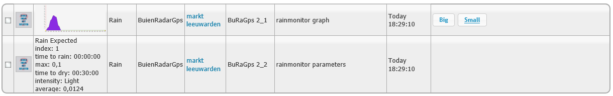

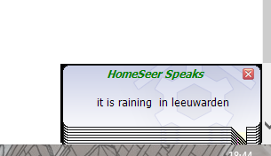

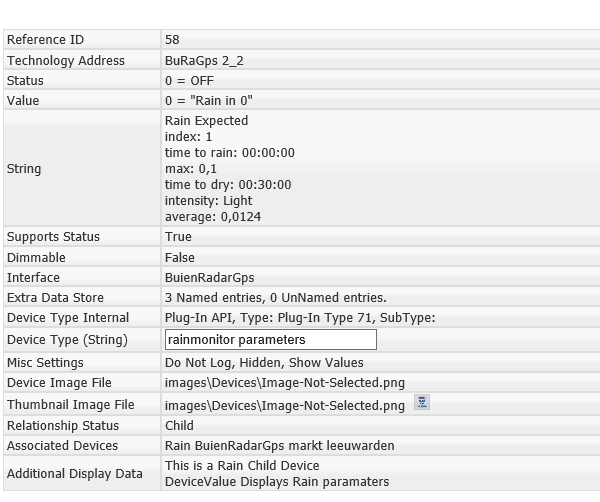

Re: Buienradar monitor HS3 plugin
yes there is progress i am testing a child device with all rain properties . since december there was very little rain here in spijkenisse so there was not much testing.
- rain3.png (19.91 KiB) Viewed 19853 times
- rain2.png (30.29 KiB) Viewed 19855 times
- rain.png (22.99 KiB) Viewed 19855 times
