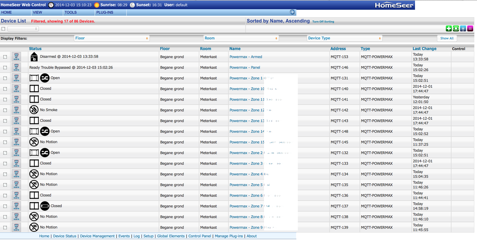

It is an extension which is based on my experimental MQTT plug-in which runs as a HS3 plug-in, the 2nd part is a linux based daemon taking care of the MQTT pubishing
/sensor/8c4ed3/powermax/panel {"powermax":{"time":1417623950,"panel":{"status":36,"description":"Zone Open Trouble"}}}
/sensor/8c4ed3/powermax/event {"powermax":{"time":1417624235,"event":{"zone":8,"name":"Living room","type":21,"description":"No Motion"}}}
/sensor/8c4ed3/powermax/status {"powermax":{"time":1417624236,"status":{"open":8193,"lowbattery":64,"inactive":0,"tampered":0,"enrolled":32767,"bypassed":0}}}
Message are flowing in one-direction, but it is doable to make it two way ....
Advantage using MQTT is that it is relatively easy to make a web based interface showing the status of your powermax panel, or in later stage arm and disarm ...
This the result of a few days of hacking in my spare time (which i don't have a lot off) I am planning to move to HS3 but the lack of powermax integration was preventing me from doing so, now I can at least make the status visible in HS3
Graphics are borrowed from Rene's HS2 plug-in (graphics credits r255)
