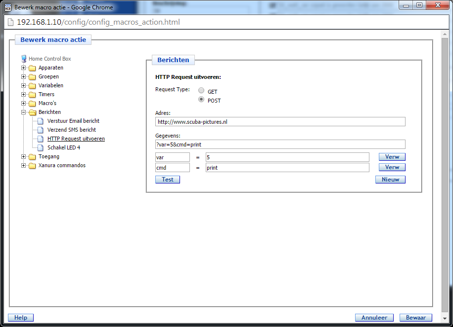

Hi Henk,
Thanks !
I did found the optional fields, but not sure how to interprete these, and make them work...
See below screenshot...
Thanks !
ron
Thanks !
Thanks !
ron

this part of the HCB is also unknown to me and moreover it is undocumented, so the only thing there is is to try.
Keep in mind that the HCB provides little data manipulation capabilities and if you fix this there are surely others will hinder register
HCB is not designed for it and 15 years ago, energy management not so hot.
Consider a microprocessor (eg. Arduino or raspberry) and possibilities of storage, processing, networking are then possible.
Regards, Henk
