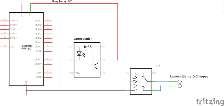

Using a relay
I thought by myself: Wow, this is a super low-tech way to connect it to my domotica system!! I can simply short the wires with a relay, which is controlled by the GPIO pins of my Raspberry Pi !
I digged through my parts stock, and found a relay that i once ordered for usage with an Arduino. A quick test with an old 5V phone charger connected to the relay, and the relay shorting the pins of the ‘DIGI-input’ of the iSense turned out that it worked great! YEAH! 8-)
Relay with optocoupler
However, the relay turned out to be pulling too much current, which the GPIO pins can’t supply. I searched around on internet, and found somewhere that if you want to drive a relay directly with the Raspberry, you need to have a relay module which has an optocoupler. The optocoupler (which only needs a very little amount of current to go into saturation) then drives the relay. The relay is connected to the 5V line of the Raspberry, which can supply more than enough power to drive the relay.
So i ordered a new relay module, with optocoupler, from eBay. Waited two weeks for it to arrive (China, items for cheap, but long shipping times). When it arrived i quickly connected it to the GPIO pins of my Pi and connected the DIGI-input of the iSense. And it works PERFECT! :D I can now automatically turn off the heating when we leave home, or turn it on from remote.

Schematic

Nice cheap way to control the isense!
If you open the relais, do the thermostat Goes back to the usual program, where it was before you close the relais?

Yep, by default it is in the 'nightmode' and when the contact is closed it goes to dayprogram. Turn off the relay = thermostat returns to nightprogram.
So this works really great, and also very cheap! Only investment was the optocoupler relayboard from eBay.
