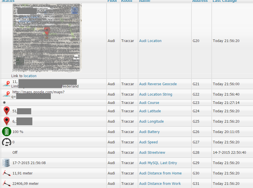

I use Traccar. Free and has apps for Android, IOS and soon for Windows Phone and compatible with a lot of hardware GPS trackers (used in my case). You run it on your own privat server/service.
Values could be stored in MySQL and with this you can get every value into your domotica system.
Lat, lon, streetaddress, altitude, speed, course, time, device_id (I have 4), etc.
Based on lat and lon the location of every device is realtime visible on a (google)map in Homeseer.
I use also some Google api's and a geocoder to calculate the distance between several coordinates, based on that you can trigger events.
Traccar has an webinterface where you can see realtime and/or following 1 or multiple devices, with all data that also is stored in MySQL.

- traccar.png (173.47 KiB) Viewed 24783 times
