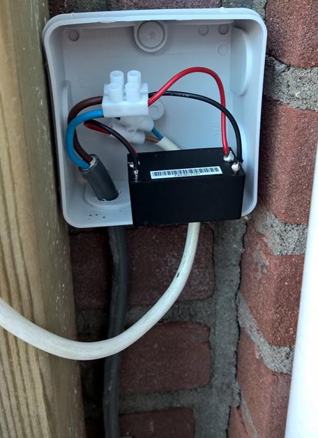

The battery for my Fibaro motion sensor has to be replaced every month...., even when the motion sensitity is set to lowest level. Based on a topic on Tweakers http://goo.gl/ITy3iY, which I tried earlier, but the space in a electric box is quit small. I was searching for an easier and smaller solution, than to use a 220V to 5V usb adapter + usb cable + 3.3 voltage regulator.
I found the IRM 05-3.3 which convert 220V directly into 3.3V. This small piece of hardware (45,7 x 25,4 x 21,4 mm) could be bought for less than 8 euros and is easy to fit in the smallest electric outside wallbox.
My Fibaro motion sensor FGMS-001 is now '220V' powered. Now the update parameters can be changed to sent certain levels more often.

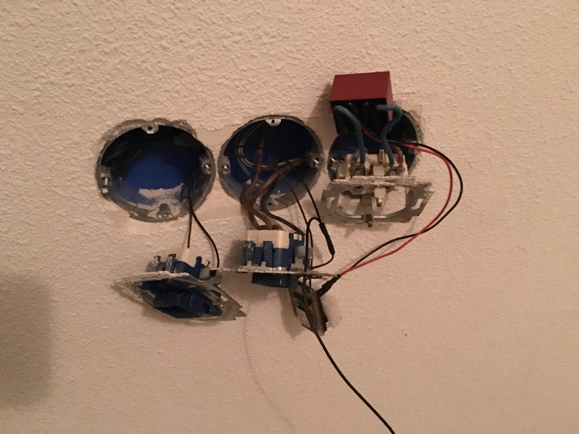

- WP_20151002_16_53_27_Pro.jpg (44.12 KiB) Viewed 28497 times

For outdoor applications i`m using this kind of waterproof box because u can use "swivels" which are more waterproof than using no swivels at all

I also found the link for the power supply

In my situation the bigger case doesn't fit in the space between the wall and the wooden part and I don't want to have the box on the left side of the wooden part
For me the IRM is a low cost solution, hopefully it will work for a long time.
