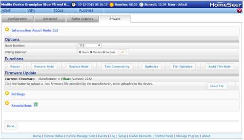

HS3 can update some devices. On the Z-Wave tab of the device there's "Firmware Update" on the devices HS3 know how to update.

Hi Morten, thanks for the reply. But I do not see any "update" option on the device's Z-Wave tab.
Could it be that the Windows HS3 version show this, and the Linux version not?

In the mean time, I have quickly installed the Windows version of HS3-PRO and this one does also not show any firmware update option on the device z-wave page, and also not anywhere else...
Has anyone ever been able to successfully update the firmware on their HSM100 devices? If so, please share the procedure.

Sorry I don't know. But I think it must be there on Linux too.
It's only visible on nodes that HS can update.
It looks like this on a Fibaro RGBW:

From what I recall, the hsm100 does not support OTA (over the air) updates so therefore that option is not available for it. HS used to have an upgrade service for this device where you needed to send it to them, but that is no longer listed in their store. I would email sales@homeseer.com to see.
