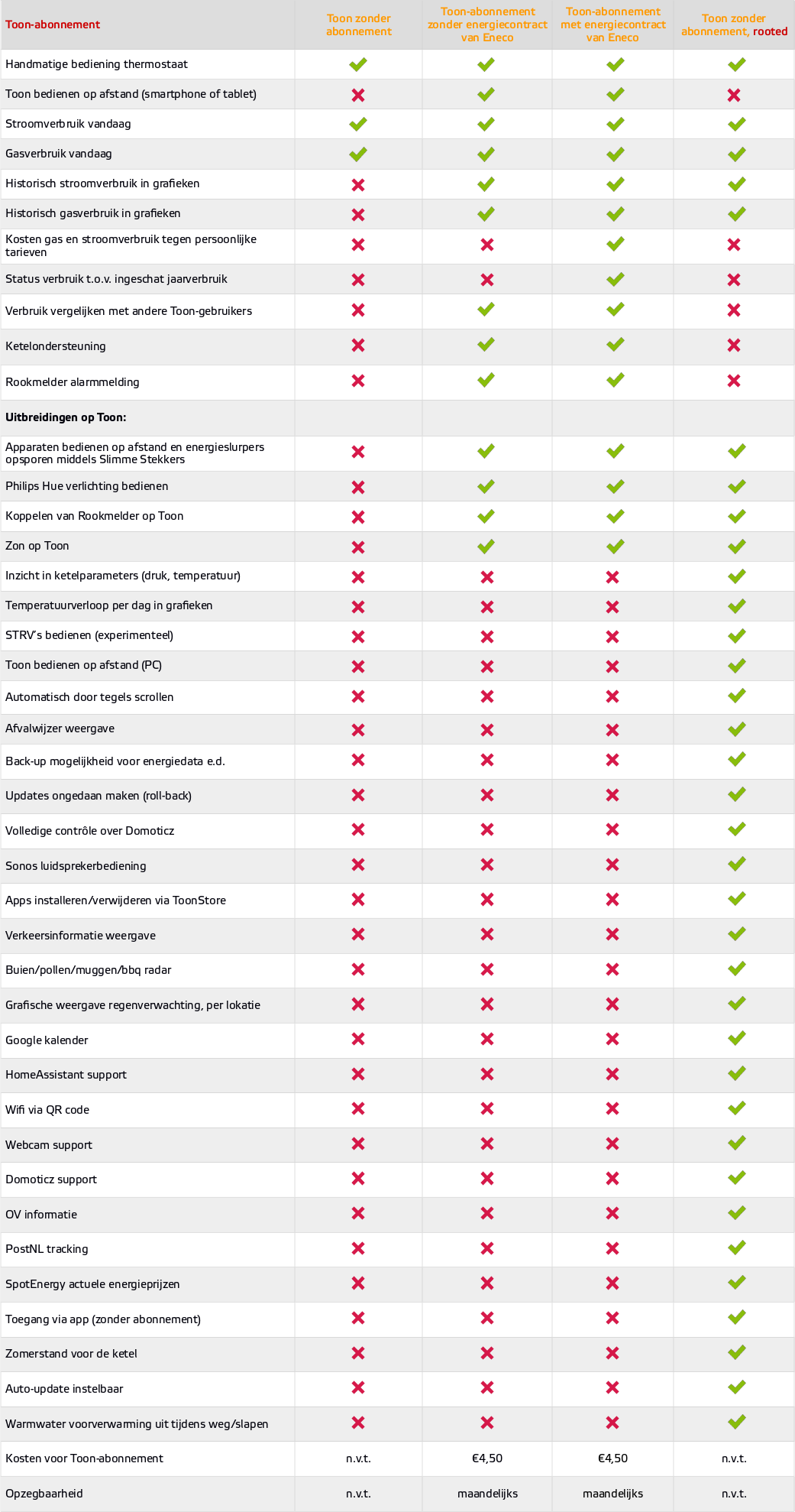

Just to give an overview what's possible with a rooted Toon: check out this list:
