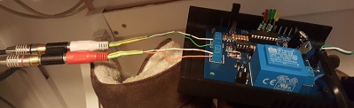

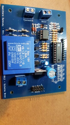

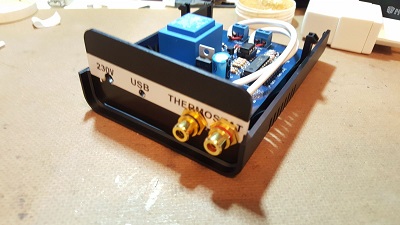

Just Modified the gateway a bit with some fancy parts to see what is going on.
Add some PIN headers
Added Pin Headers to the mainboard
Added RCA connectors
RCA Connectors for better connection and easy mount/unmount
Add some LIGHTS
Added lights to the cover
In this case now I can actually see what is happening.

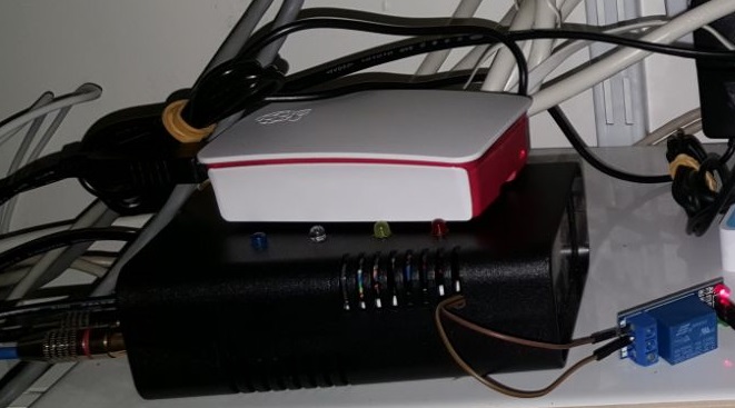

I'll add a warning to my monitor so that in case I did not receive an update I will run to the boiler to see if I can find something suspicious before it resets the PIC.
This simple relais is my PIC reset it is operated by a Mysensors Node. Currently in "Try-Out" Position aka test-setup. :)
PIC Reset
PIC Reset
PIC Reset.jpeg (63.75 KiB) Viewed 20557 times
