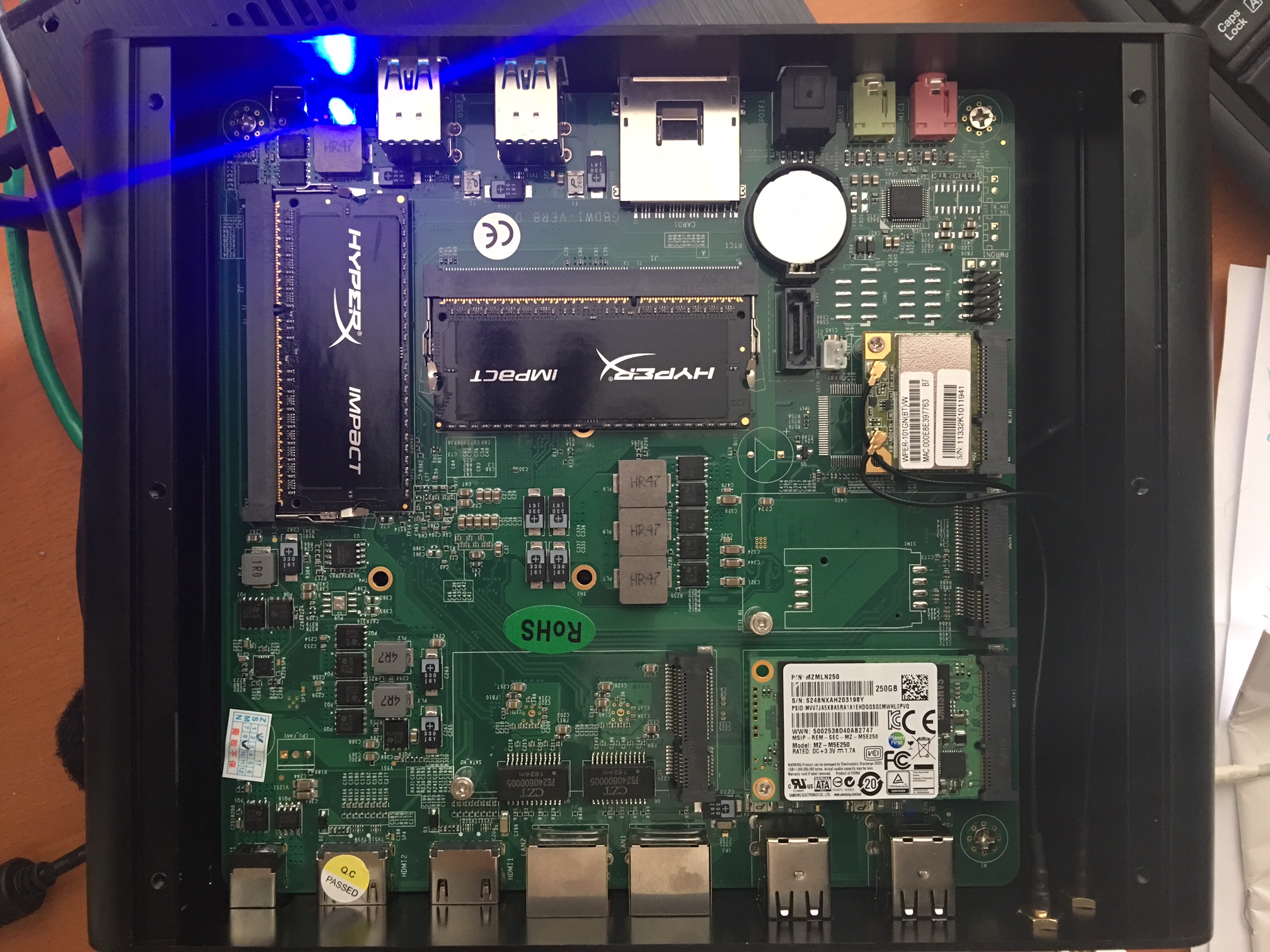

btw: Here is a picture from the inside also
