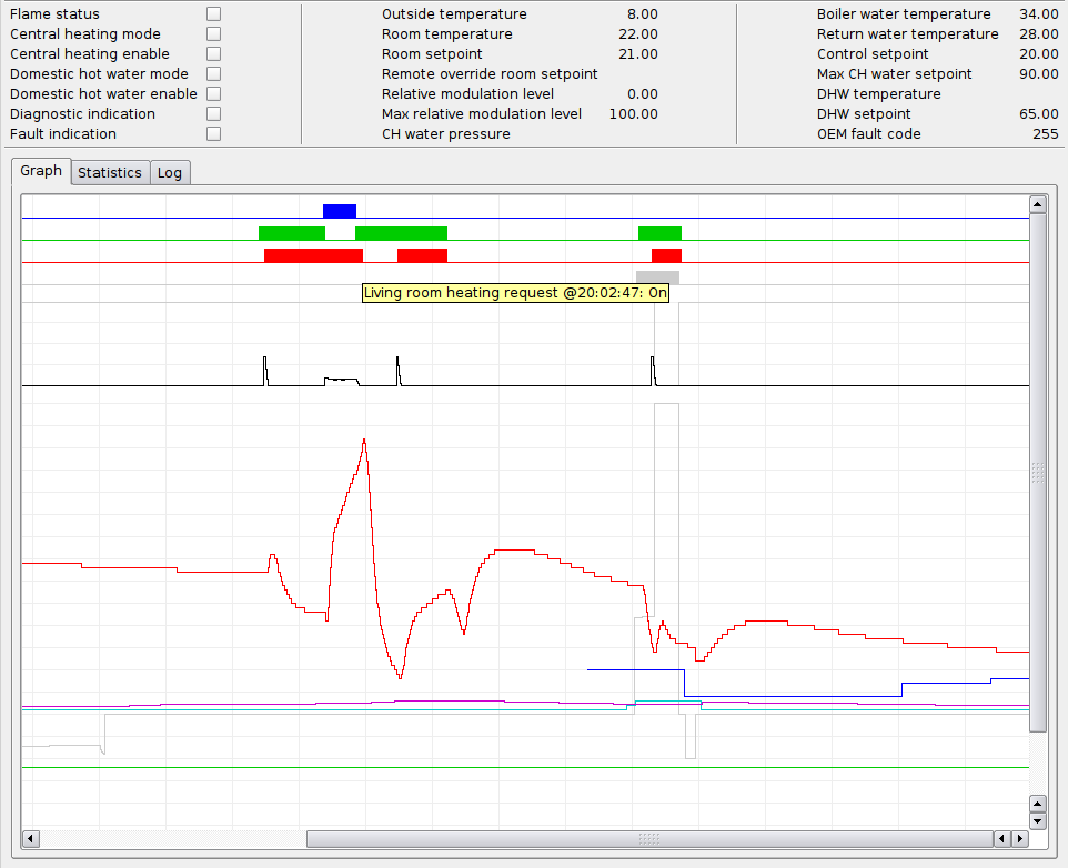

I got it working and can now monitor living room and second group individually.

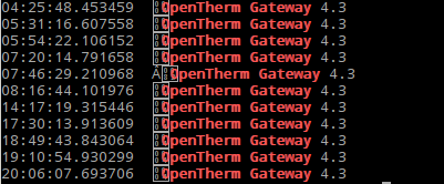

But I am now facing a hardware issue: the OpenTherm Gateway is resetting multiple times a day.
2017-01-28 20_48_35-otgw reset.png (10.28 KiB) Viewed 5496 times
Initially I thought it was caused by my sw changes, but even with the original firmware in monitoring mode it happens. As I drive 5 LEDs and the external relais (only the optocoupler, not the coils), I upgraded the transformer to the 130mA version and the regulator to an SMPS version, but the reset still occured. AFter studying the log I found that the reset always occurs within the first 2 minutes after the living room enabled the chenable bit. So I sat close to the gateway for some time to watch the unit reset and then I learned that the reset occurs when the pump of the floorheating is started by the WTH pump switch when its temp sensor detected hot water. To verify that I unplugged the pump switch and plugged it in and again it triggers a reset of the gateway. As this pump is not controlled by the gateway the only link is the mains connection. Both the gateway and the pump are on the same group and phase. Relocating the pump cord to another phase using an extension cord solves the problem, but this is not feasable my application. So I will have to do some filtering on the pcb of the gateway.
Does anyone have some tips?
Will doubling the C1 and C2 elco's and adding a 10nF cap between VCC and GND of the microcontroller do the trick, or do I need an mains input filter as well?
Posts: 2035
Re: Opentherm Gateway as zone controller - firmware modification
Adding the caps would definitely be a good first step towards a remedy.
