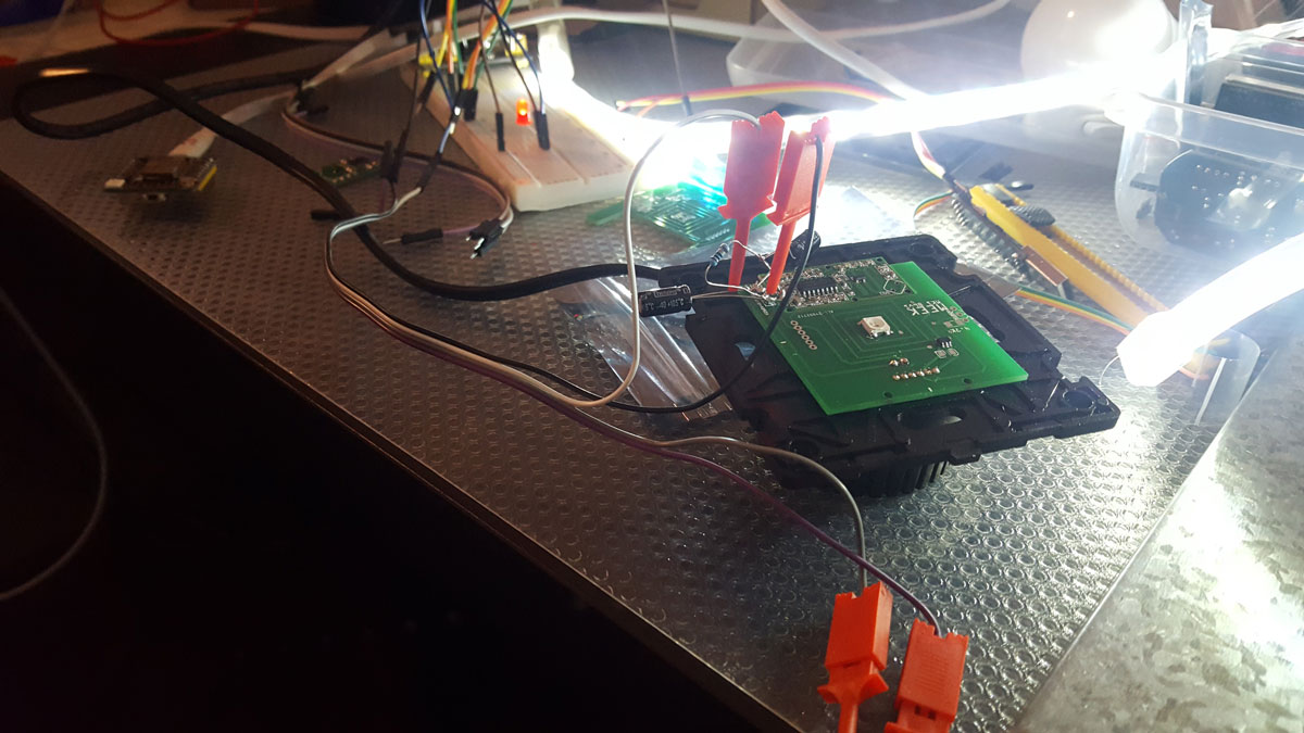

So without further adue, first of the many steps, was to integrate all my switches to Domoticz. Simple idea, nevertheless, there were not suitable equipment/design switches available. To be honest, i was charmed of the design of some of the touch switches as you’ll see below.
So i’ve ordered a few to fiddle around with it and finally to suit it with an ESP8266 12-E variant in it with ESPEasy flashed on it for future expansions that I have in mind.
I found out that his internal PCB did not delivered sufficient energy to power up an ESP12-E module, so I’ve created a dirty PCB with and equip it with several components to power up and switch 230V.
I have now a “dirty working setup” to do some more testing.
Till now, the ESP is working pretty stable and and soon I will integrate the first “MEEK Switch” into my walls to do more testing in a real life environment.

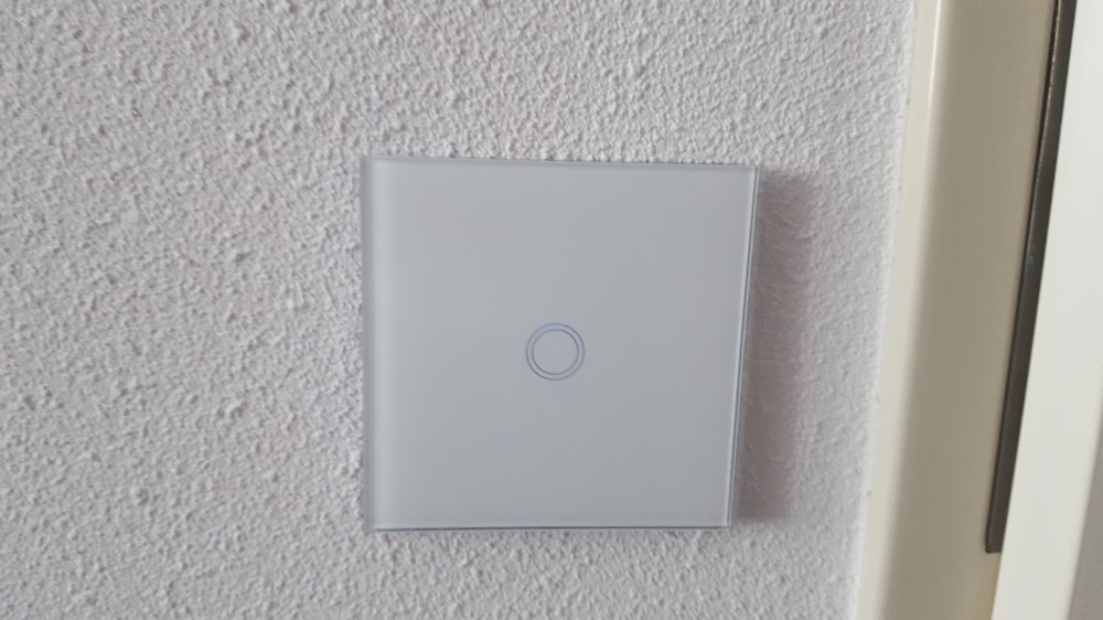

I’ve just installed the Meek switch in my wall and it’s working like a charm :D
Herewith the link of the video I’ve made : https://www.youtube.com/watch?v=IxXZHxCzjdg
There’s still a lot of work to do but this is the first small step :)
I’ll need to redesign the PCB to fit a triac instead of an Solid State Relais, as the last one did not fit well in the casing I’ve got. Once I have this sorted out, I will post the schematics over here so we can discuss about it and perhaps, make the switch even better !

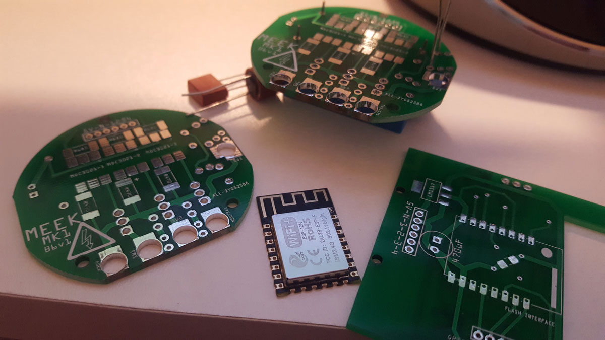

Update 16-Nov : I’ve finally received the PCB’s 
Meek A5v1.jpg (67.28 KiB) Viewed 26309 times
I’ve also received the most of the electronics that I will solder on the boards.
Next week, I hope to assemble the Meek switch and once ready, I will upload a video on Youtube 

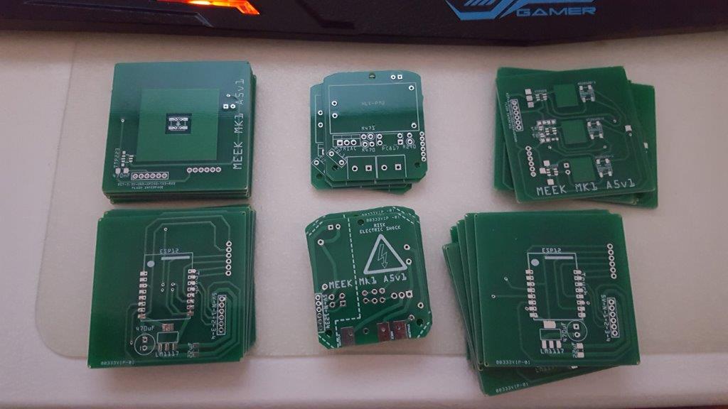

Hello, as promised, the Meek A5v1 has been assembled.
I’ve uploaded a short video of YouTube :
During the assembling process, I’ve discover an inconvenience (my way of saying that I’ve made a childish error :oops: ), therefore some amendments had to be made during the assembling process.
This caused a misalignment of the WS2812B and therefore the illumination of the switch is way off.
Nevertheless, it’s been a successful Alpha/trial and in the Beta versions, some extra modules will be placed like the RCWL-0516 and perhaps a DHT11 sensor as a test.

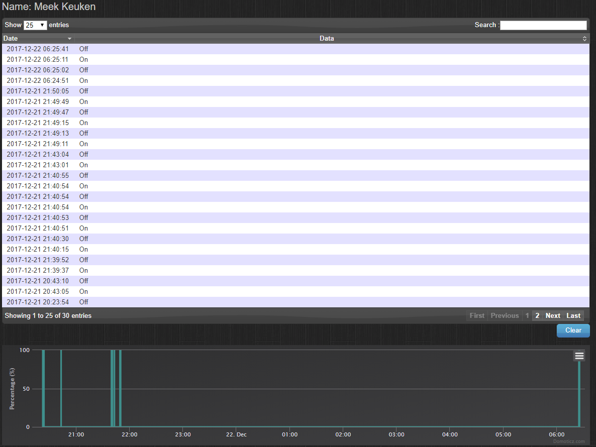

I’ve assembled the Meek (Beta 7) switch with an integrated RCWL-0516 module and with all the filters, the accuracy improved enormously.
That been said/written, in the first night where I tested the Meek switch, he gave 3 “false positives” during a 9 hours trial.
I’ve setup the switch in my kitchen that overlooks at our garden. It could be possible that there were some animal activities that has been captured by the sensor but I cannot tell for sure. But no matter what caused the “false positives” the results were not satisfactory.
So I went back to do more testing and measuring and found that by repositioning the sensor (although it’s a 360degree sensor) the accuracy improved even more !
Tonight, I will conduct a test in my attic to rule out “jammers”.
I’ll keep you posted.

The last test over a period of 10 hours, had a hit rate of 100%.
Now I need to finalize the code/rules to operate on motion once the Lux meter drops to a certain level.
After that, I will install it in my kitchen an post a video of the operation.
